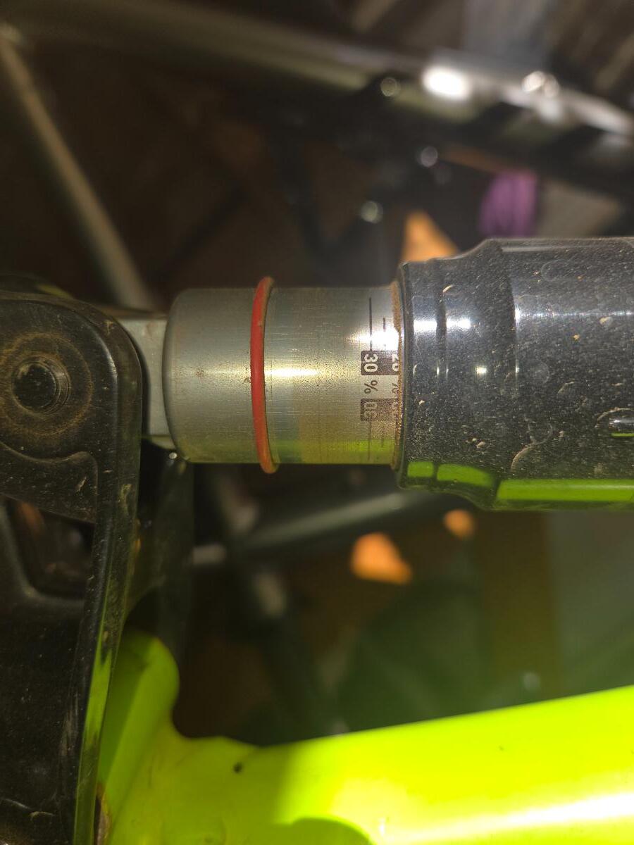

  7. Got hold of knipe racing, super awesome service and they told me exactly what to do, then I'll test it again and check
  8. The shock was actually serviced in Jan by Knipe racing, since then the bike did 2 xco events and maybe 100km road cycling, will give them a call tomorrow and find out what we can do, maybe it's still under service warranty
  9. Do you maybe know what a service like that will cost me? My bearings and everything is smooth.
