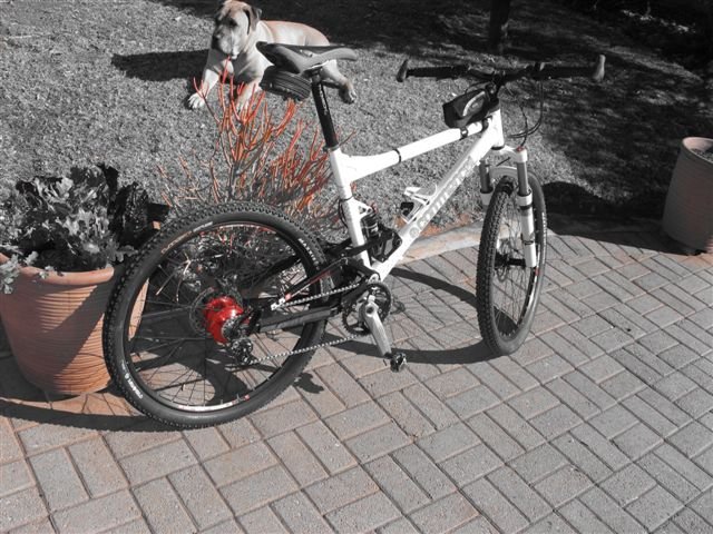

  4. Got my bike on Friday, so went for a nice ride yesterday. The instant shifting and the grip shifter takes some getting used to, but otherwise this thing is out of this world. After one ride it's obviously too early to compare against my old X9 / XT / LX setup, but for now I can't wipe the smile off my face!

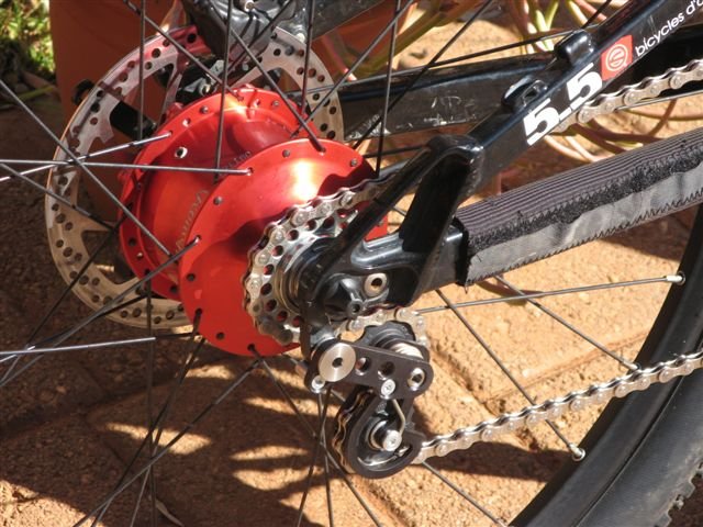

  6. they say you add just under 500g to a XT / X9 setup and roughly 350g to a LX / X7 setup. The hub weighs in at around 1.7kg, but you throw out both deraileurs, two chainrings, the casette, the standard hub, one shifter and about 1/3rd of the chain.
  7. Still waiting for the final quote, cause they have to fit a chain tensioner etc because it's a full-sus bike. The price on the hub itself is around R13k - R14k...
  8. I bit the bullet. My bikes at BRC right now being converted to a "maintenance free rig". I did some calcs based on the rate that I replace / break / wear drive components (Deore / SRAM X7), and it seems that the "rohloff conversion" will pay for itself in less than 5 years (10000 km)rudi-h2010-06-17 08:25:08

  10. Thanks for the tips. I didn't think of the whole "break the frame" aspect to get the belt on, so there goes the "belt drive" idea. Might consider the internal hub with chains / sprockets instead. Seems that in a 10 year period I will most likely go through 2 rear deraileurs, 10 chains, 3 sets of chain rings and 5 casettes. With that in mind the R10k knock once-off is maybe worth while. Not to mention the super smooth gear changes... I ride hard and fall often! If you didn't fall, you could've gone faster!!! - myself Anybody knows where to shop for internal gear hubs?

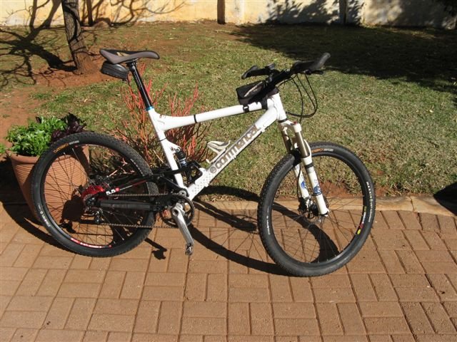

  11. I've done around 5000-6000km with my mtb, and this seems to be equivalent to driving a car past the 250000km mark. Everything is just on the verge of giving in. Deraileur is dodgy, chainrings are buggered, cassette and chain is blown, shock stanchions and seals are mangled etc. If I take my bike (commencal full sus) to a bike shop for a "full service" I would expect a bill of R6000 - R10000 (with replacement parts). My question: What does it cost to maintain a bike fitted with a belt drive and rohloff hub? Anyone that has such a rig that can give some advice? Is there anybody in JHB that sells Rohloff hubs and belt drivetrains where I can get some info and prices?rudi-h2010-06-13 06:21:20
