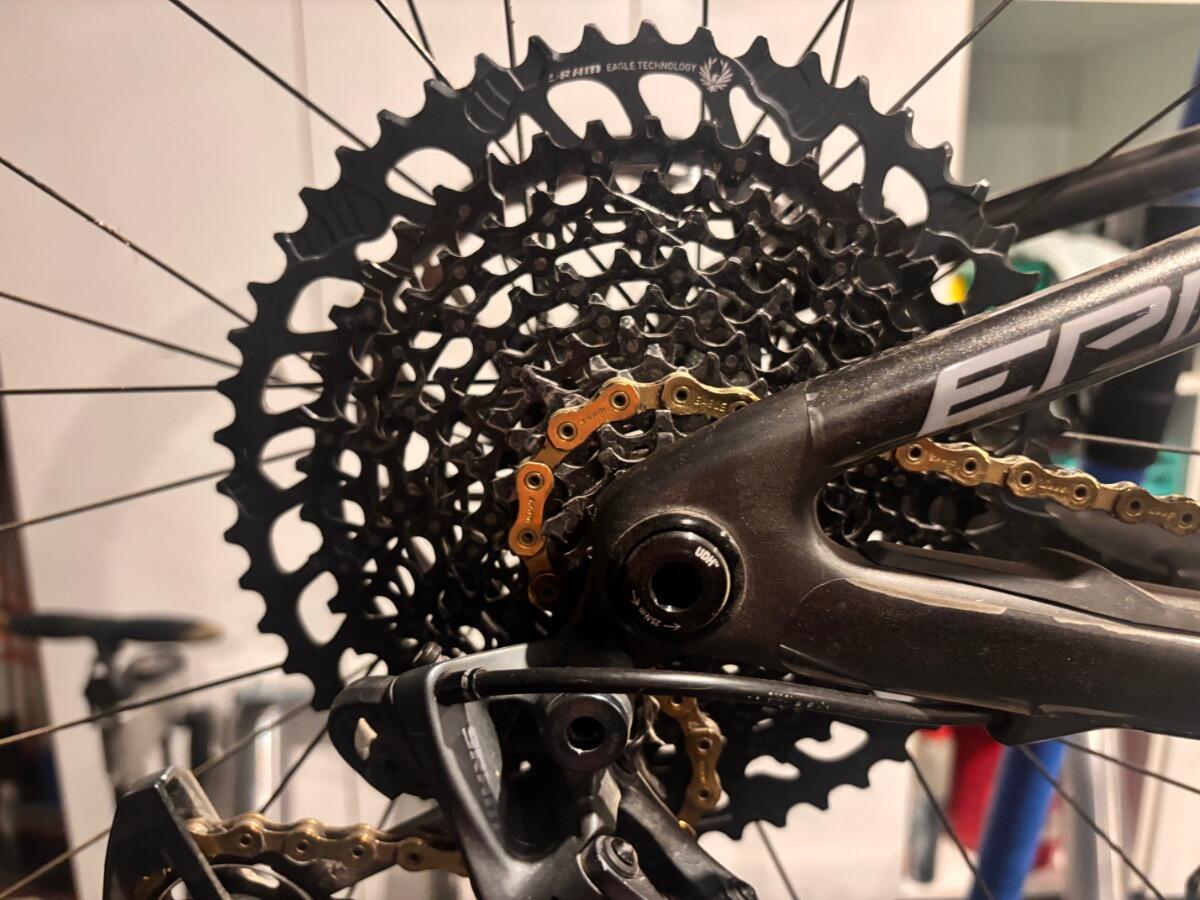

  1. IMG_2274.mov This is the gear that the chain is slipping on. This was a brand new xx1 chain GX cassette (XG1275) and GX chainring 1339km ago. There is obviously a lip on some of the teeth, from mushrooming I suppose. Confused about why the cassette looks like this so early when I ve had over 11000 km from mt other 12 speed sram cassettes. (see the very first post)

  4. Thanks. I hadn't considered the free hub slipping. It a DT350, and from what I hear they're pretty bombproof? Oh Ill have good look over the cassette. See pictures of it below if your interested.
