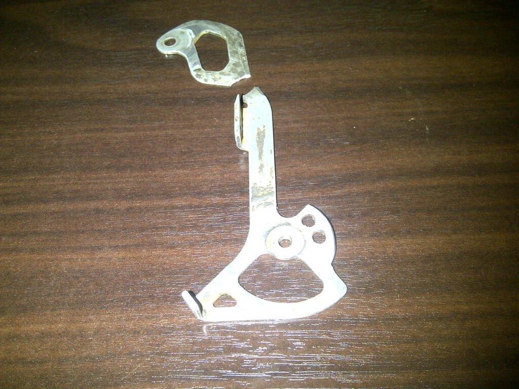

So my bike breaks the derailer hanger, not content with that its also managed to mangle a couple of spokes and after fitting a new hanger I see its also buggered up the lower cage, broken in half buggered up!
Can you buy this piece on its own anywhere or am I now stuffed and have to buy a whole new RD? And for interest sake, the same piece off a 9sp XT unit does not fit, the holes are out by about 2mm.
Edited by Mojoman
Mine broke this weekend at the Magalies Monster. Almost 11000km on it, due for new wheels in any case. I replaced it with a new Shadow + derailer. My lbs will try get me the spares, and this one will be my spare!
R95 from Cajees, unfortunately it appears my derailer is a bit bent...! (struggling to sort out shifting, hanger is new so it can only be the XT derailer). :thumbdown:
