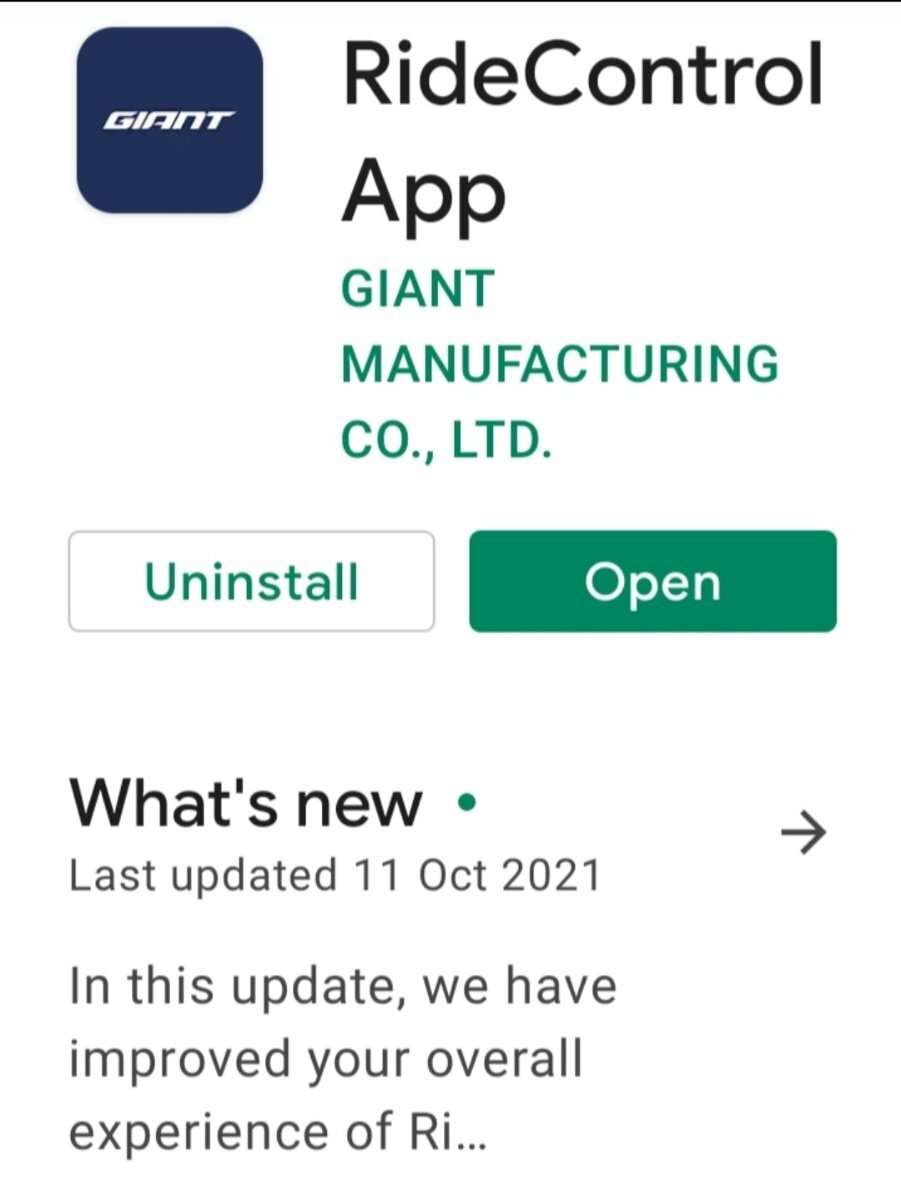

Richard tiplady Posted November 28, 2021 Share Chris I am using ride control is that the right app. Thanks so much for the help Link to comment Share on other sites More sharing options...
ChrisF Posted November 28, 2021 Share Yes, that is the correct app. I found the assist on "1" to be too much. Detuned 1, 2 and 3. I use an old phone on prepaid as my cycle phone. I only link this at home. After a firmware update I had have the location function on the phone switched on, in order to link the phone and bike. This is on a 2019 spec Trance E. Link to comment Share on other sites More sharing options...
ChrisF Posted November 28, 2021 Share I updated the App on my phone, then did a firmware update to the bike. Checked, the power settings are stil the same I set it 2 000km ago ???? Link to comment Share on other sites More sharing options...
