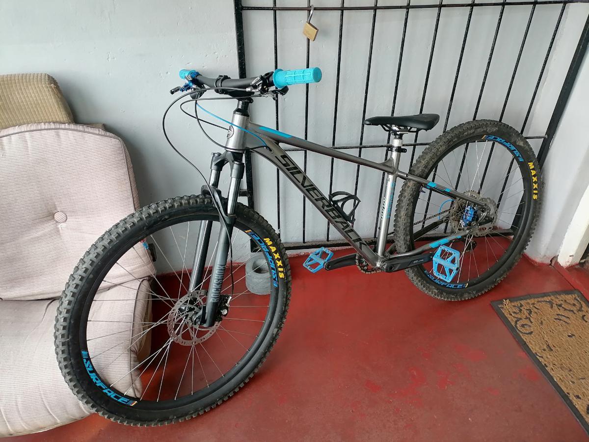

Your Bike Won't Crack
You Sure Its a RS Judy Specs Show Suntour ?

yes,ive got a bit of a strange build spec, its rs judy QR(blah) fork with shimano deore groupset. but since then ive actully spent more on the up grades than the bike is worth.

You Might be able to UP that Fork to 120 mm by removing a spacer or 2.
Depends What Air Spring is Inside It.
It does make a Difference.
Your Bike Looks Good.

I've only seen 1 cracked Stride frame, and I handled their warranties, local and internationally, for a few years.
Anything above 120mm travel will void the frames warranty. The frame was designed for ideally 100mm travel, but can take up to 120mm.
