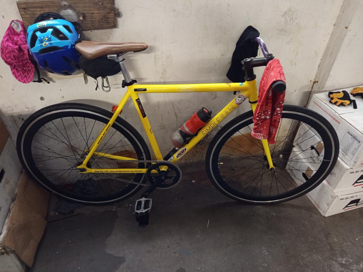

  1. Just an update , if anyone is looking to get into single speed and even more , as in fixed gear , then you would not be out of place aquiring a Simple SAM....Ive done just over 6000km on my yellow SAM , that's everyday commuting, work n back ...40 odd kays a day , 6 days a week , this bike is a SOLID BEAUT!!!....I changed the hubs to Novatech and put in an upgraded bottom bracket , a old school seat post and covered an old saddle in brown leather ....put on a lightweight set of handlebars ...other than that , this SAM is the real deal!!!

  3. I know this is from 2021 , but I've been looking for a fixed gear/track bike frame ever since I converted Giant OCR3 into a fixed gear ...Did 3000 odd kays on the OCR3 , but , it's not quite the real McCoy... As I got the hang of fixie peddling , I WANTED a proper frame , but these frames tend to be a tad pricey... Rook I was eyeing, but still not quite took my fancy and then happened on the Simple SAM website .. Did some more investigation, got to this thread and read even more and only found good solid things being said about the SAM... I've now acquired one , a Yellow SAM , and I tell you what , I am BLOWN AWAY!!!.. I peddle to work and back everyday and have already put on 250kays in a few days , SAM is nippy , fast and smooth as you like .. I put my own saddle and Thomson post on , with a decent set of handle bars... Next I'm swopping the Joytec rear hub for my Novatec sealed hub... So , all in all , I'm pretty damn impressed!!!
