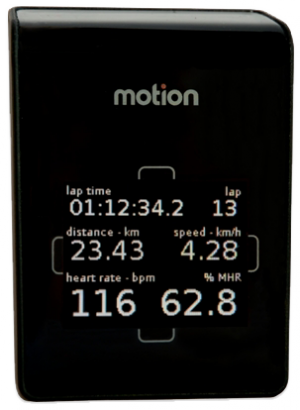

i think your options are
garmin 310xt
fenix 2
suunto ambit2
interestingly bryton is not on the list, but mobii is. yup those smart okes from cape town who made this gem - http://www.mobii.com/systems.html mobii_Motion--300x410.png
