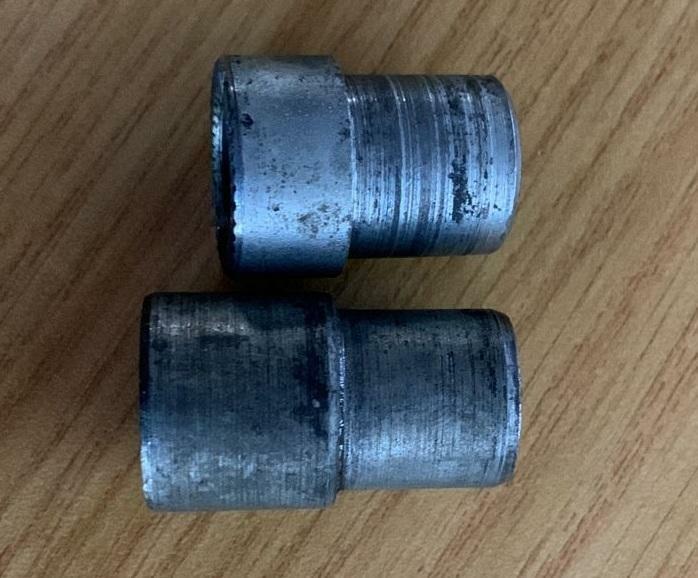

Marccash Posted June 5, 2023 Share Good afternoon, Help....... I am looking for a 148x12 Thru axle adaptor for an Elite Suito Trainer. if I can get accurate measurements, I will have it made. Link to comment Share on other sites More sharing options...
Thomo Posted June 5, 2023 Share I've reposted ad for quickest reference. Will have to check if it is still in the garage if it is what you require. https://bikehub.co.za/classifieds/item/indoor-trainers-and-accessories/554131/12mm-ta-elite-axle-adapters-xrsuito Link to comment Share on other sites More sharing options...
Thomo Posted June 5, 2023 Share Apologies, I see that's only the 142 fitting and not the 148 adapter. Link to comment Share on other sites More sharing options...
Marccash Posted June 5, 2023 Share Hi Thomo, If you still have this available i will take it. Its only 6mm shorter than what i need. Link to comment Share on other sites More sharing options...
TheoG Posted June 5, 2023 Share 4 hours ago, Marccash said: Good afternoon, Help....... I am looking for a 148x12 Thru axle adaptor for an Elite Suito Trainer. if I can get accurate measurements, I will have it made. I have both the 142 and 148 for my Elite Suito. PM me, I can measure them for you with a vernier. Link to comment Share on other sites More sharing options...

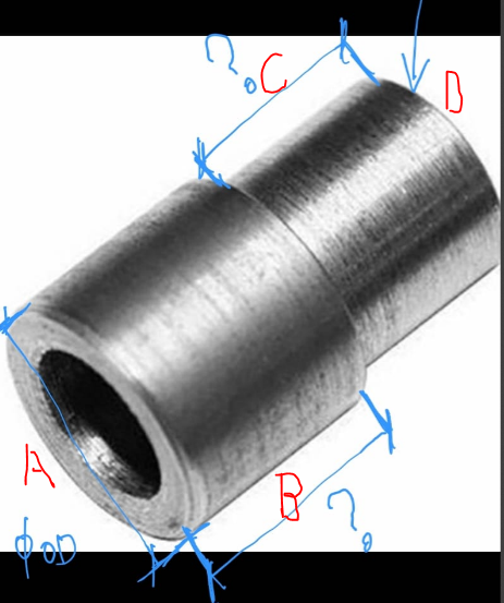

julianshandlebar Posted June 20, 2023 Share Hi there, I have lost the same adapter. Just checking if those measurements were taken - I'm also looking to have an adapter 3D printed. Link to comment Share on other sites More sharing options...
TheoG Posted June 20, 2023 Share 15 minutes ago, julianshandlebar said: Hi there, I have lost the same adapter. Just checking if those measurements were taken - I'm also looking to have an adapter 3D printed. Yes, I gave it to @marcash via whatsapp. Will repeat for you: The one for 142 (std) and 148 (boost) is the same, only the "base" is 6mm longer for the boost one A = OD 19mm (Std & Boost) B = 10mm (Std), 16mm (Boost) C = 15mm (Std & Boost) D = OD 16mm (Std & Boost) ID = 12mm (Std & Boost) Let me know if you need more info. Edited June 20, 2023 by TheoG Link to comment Share on other sites More sharing options...

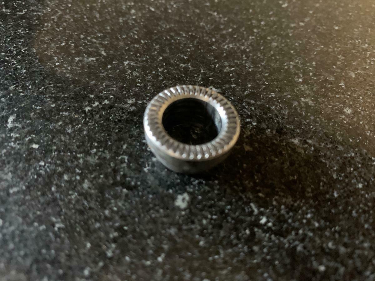

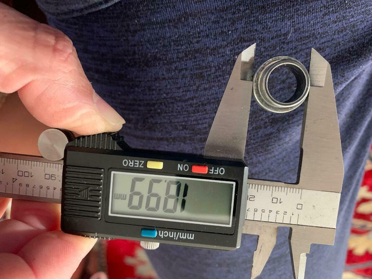

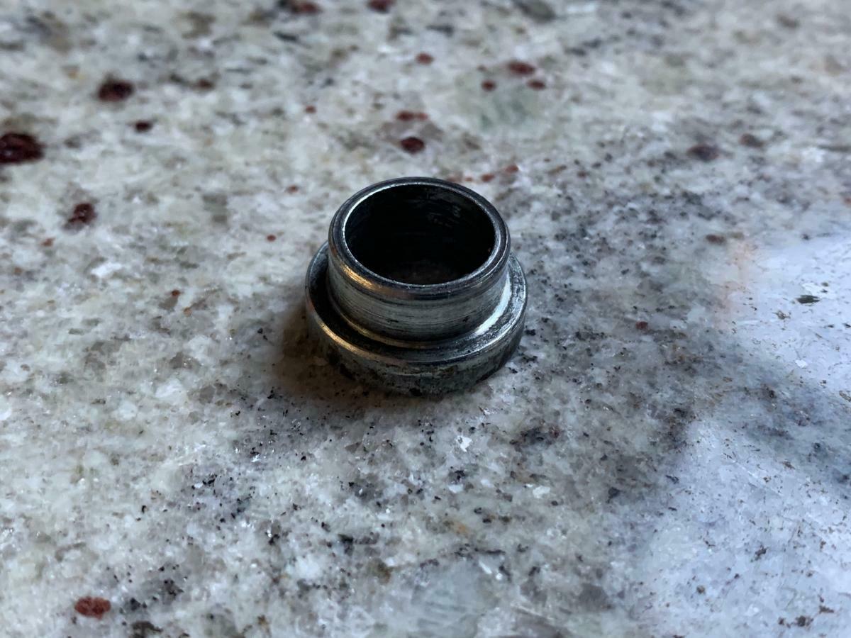

julianshandlebar Posted June 20, 2023 Share Thanks @TheoG! I have actually lost the smaller part (part F in the image below): Do you have access to those measurements? That would be soooo helpful! Link to comment Share on other sites More sharing options...
TheoG Posted June 20, 2023 Share I do have it, will have to measure it for you. Its on my trainer at the moment with bike on it so will have to disassemble, how urgent do you need it? Edited June 20, 2023 by TheoG Link to comment Share on other sites More sharing options...
julianshandlebar Posted June 20, 2023 Share Thanks @TheoG, whenever you have time! Appreciate it. @Marccash if you purchased the adapters and don't need the smaller one (F), let me know if I can buy it from you. Link to comment Share on other sites More sharing options...

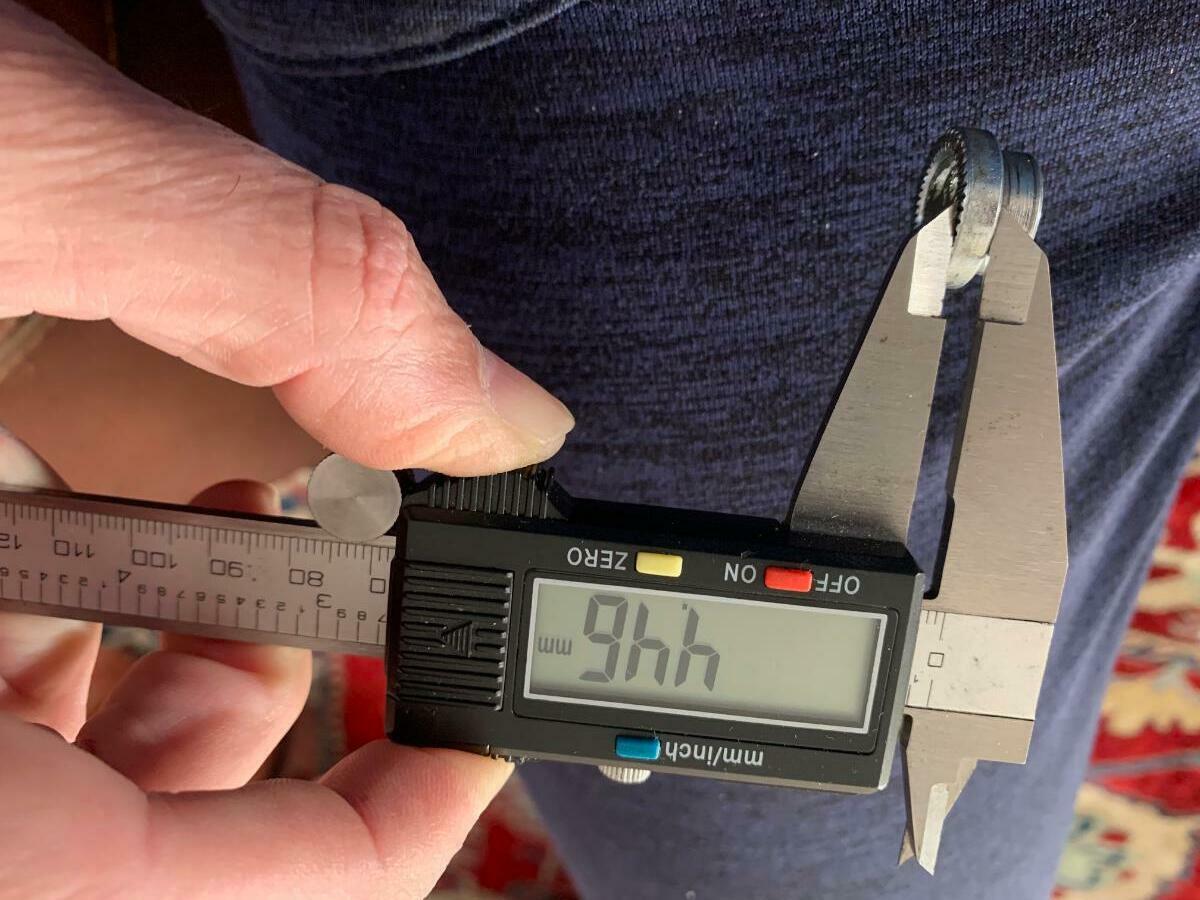

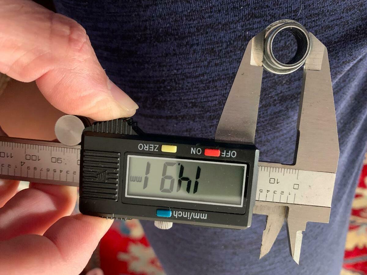

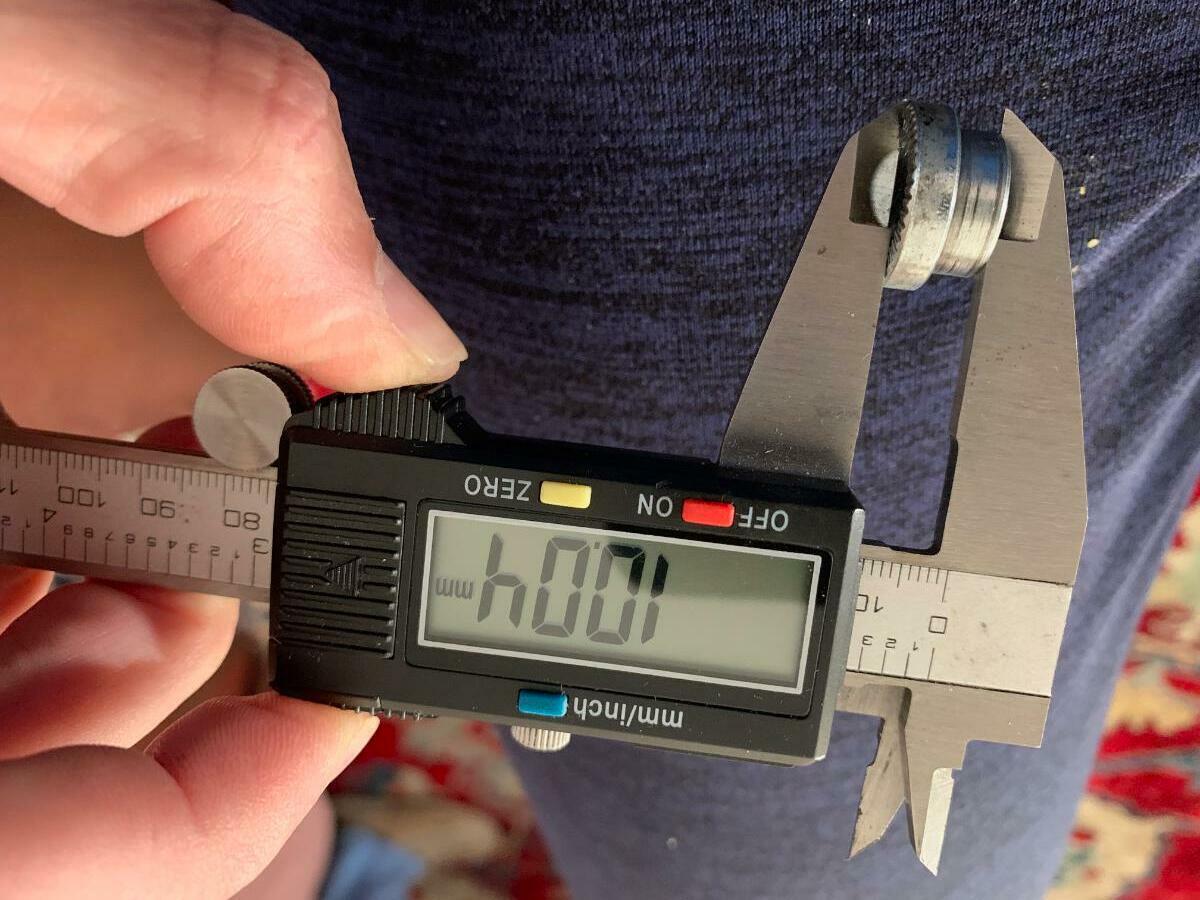

TheoG Posted June 28, 2023 Share 38 minutes ago, Marccash said: Hi Theo, were you looking for me I didn't get a PM. Weird, I did send to you, anyway here you go ... Link to comment Share on other sites More sharing options...
julianshandlebar Posted June 28, 2023 Share @TheoG, thanks so much for these measurements! Appreciate it. TheoG 1 Link to comment Share on other sites More sharing options...
