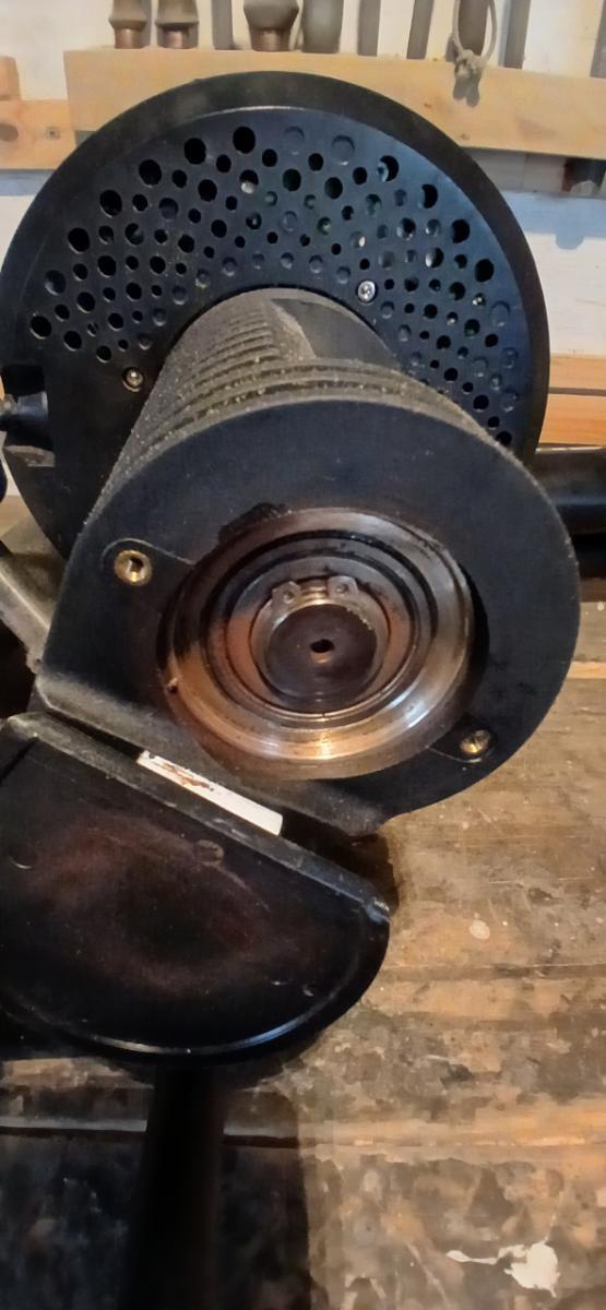

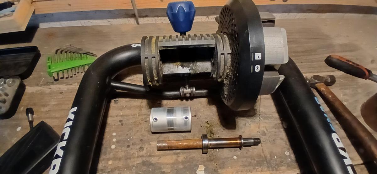

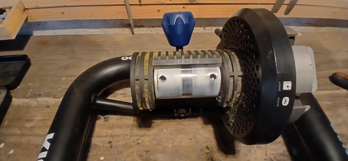

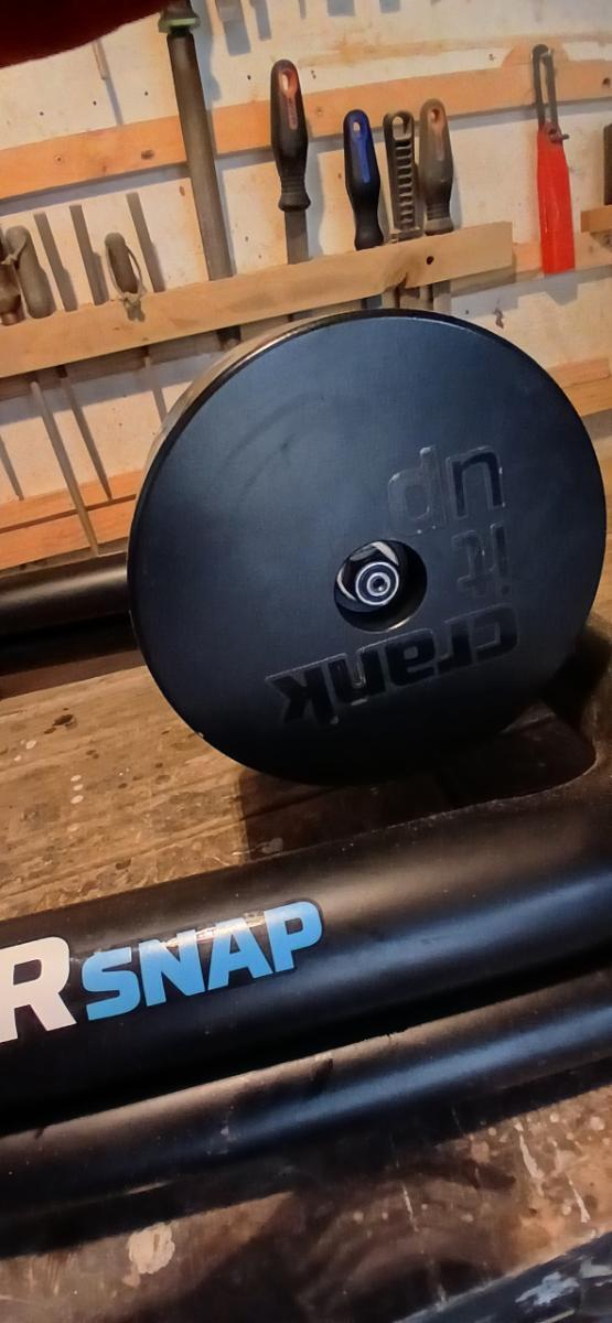

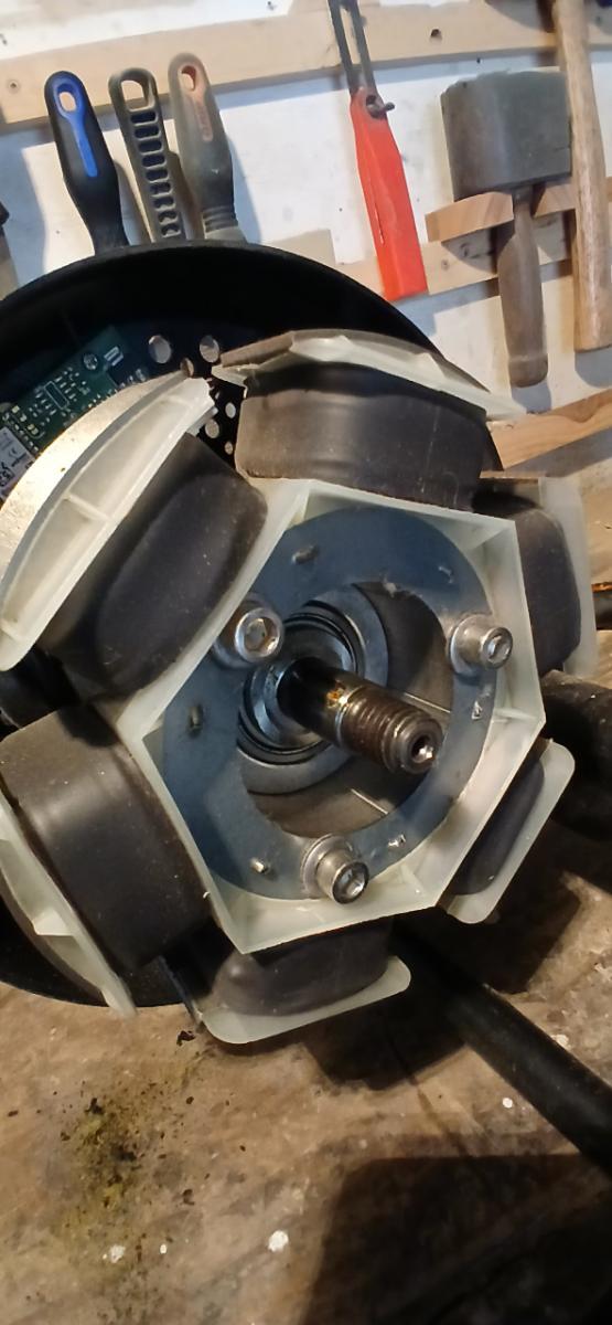

  5. My Kiclr started to become very noisy after 5 years of use. i was not able to feel bearing play from outside, but could also not tribute the noise to something else. I contacted the local distributor for service instructions, although they were quick to respond the official reply was "the bearings are not replaceable" So here is my guide on replacing the snap 2 bearings Bearings: 2x 6003 RS2 (they are dirt cheap) Tools: good (low tolerance set of hex keys) 19mm socket on impact driver 12mm wooden dowel and hammer Circlip pliers Procedure: Open the cap on the non fly wheel side and remove the circlip ( you will probably find rust dust ) so clean out as you go along Remove the cap on the fly wheel Use the 19mm socket and impact driver to remove the nut holding the fly wheel ( without a impact driver its almost impossible to hold the flywheel and crack the nut lose ) Carefully slide the fly wheel off .. not a key in the axle witch you need to remove and put aside for now check that the white sicker is not coming lose or dirty (its the optical speed pickup reflector and can be replace if required) Remove the grub screws on the roller. they are locktited in well and you need a perfectly fitting hex key to get them lose Using a wooden dowel or similar , tap the axle out from the non flywheel side, if there is no rust it should be quite easy. Gently tap out the non fly wheel side bearing and remove old flywheel side bearing from axle Clean off all the surface rust on axle and bearing seats and clean up anything that looks dirty I used lots of grease on everything put back. Place new bearing on axle and shaft down to flywheel end Place new bearing in non flywheel side Reinstall the axle from flywheel side sliding it through the roller and other side bearing Install circlip Align Roller with notches in axle and tighten down the grub screws Replace the Key and Fly wheel and bolt down replace cap and non flywheel side cover and you're good to go Done!
