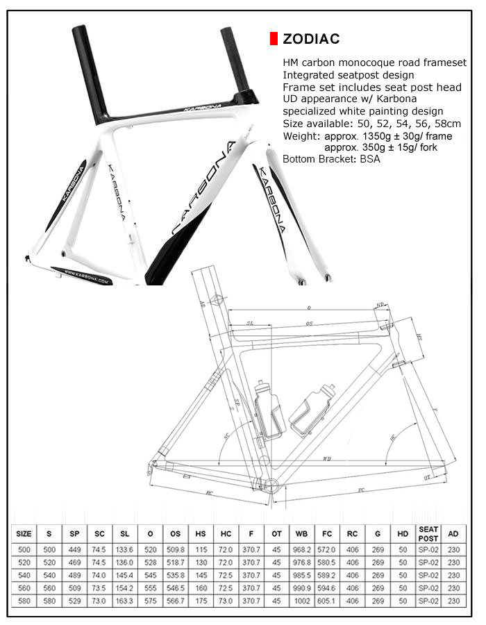

I bought a second hand carbon road bike with an integrated seat post (not the most intelligent thing to do), and when I took the bike for an initial spin, everything felt fine. In the meantime, I have started to develop a niggling pain on the inside of my right knee during long rides, so today I took the bike for a professional fitting.
Surprise, surprise: the saddle is too low - along with one or two other things that need to be changed on the bike which aren't an issue.
So my problem now is that I need to gain 16mm in saddle height, but the seatpost has been cut too low. When lifting the seatpost cap to its desired height, the fastening mechanism barely catches on the inside, so there is not enough stability for the saddle.
A 27.2 seatpost does fit, but that would mean cutting into the frame to install a clamp and I loathe to go this route as I like the look of the ISP and hate the thought of taking a blade to the frame.
Does anyone know of a person that would take on a carbon repair like this in South Africa? I have searched on the internet but could only locate people either in the USA, the UK or Australia.
