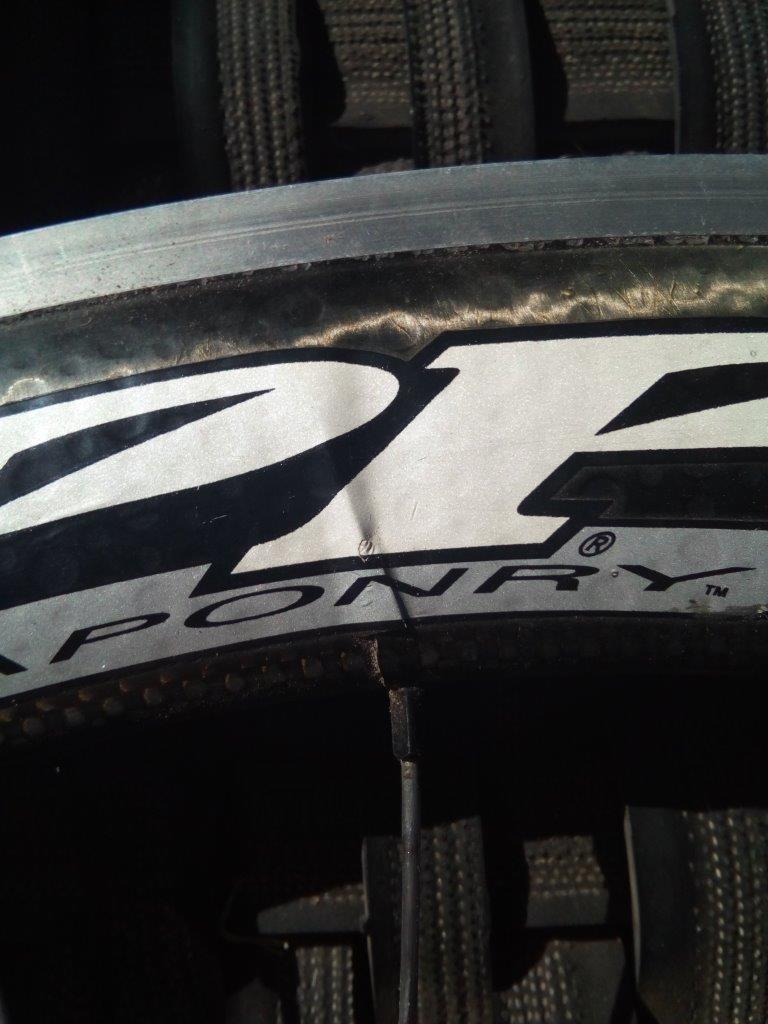

Need some ideas/opinions on what to do with my damaged rear Zipp 404 wheel.
I bought this wheel second hand, as part of a set and the rear was already repaired in one spot.
Afterwards I took the wheel to a LBS and they told me it is not entirely true and that they will have to rebuild the wheel with new spokes and nipples. I recall that they said that they had trouble getting the nipples off and that they will have to cut the spokes in order to remove them.
The spoke then pulled through and damaged the rim in the process.
See attached picture.
I have since then asked another LBS for quotes on repair but nobody except on guy agreed to do it and they quoted something like 3k to do it with no guarantees. I am not sure if I can trust the wheel with it repaired.

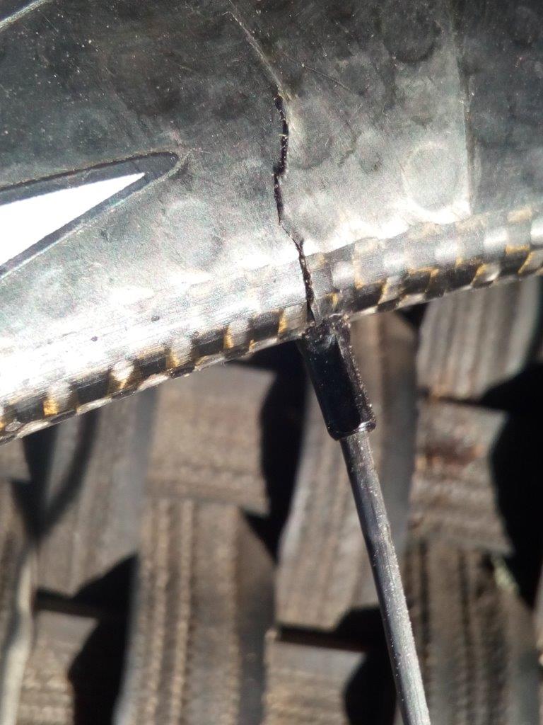

Image2: Other side of rim at same place, looks worse

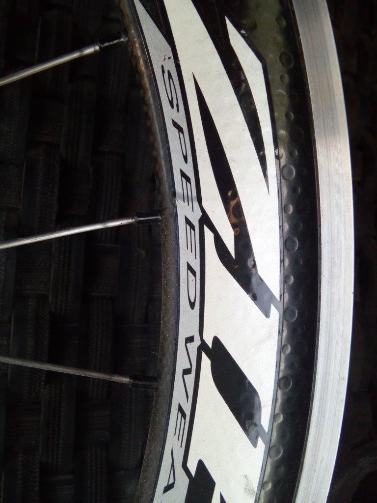

Image3: I now see there is damage at another spoke also  :wacko:

2:1 lacing on any wheel is asking for trouble.
Repairing carbon rims is asking for trouble - frames are fine as they are not as dynamically loaded as rims.
Scrap the wheel.  2 to 1 lacing will not work as the rim holes are drilled left and right to give the spoke and nipple a straight line to the hub flange.  Pushing a spoke the wrong way will give you a kink in the spoke at the end of the nipple.
I would not recommend repairing a carbon rim.  It can be done but I have had mixed results when re building repaired rims.
Sell the hub or look at a new rim.  Check out www.light-bicycle.com.  Chinese and not the cheapest but good quality and support.  Only slightly more than your repair quote.
I had my carbon MTB rims repaired by James at CBR in Durbanville - he did a fantastic job but didn't seem that keen on repairing as he couldn't guarantee the result.  I had to insist and I only got them fixed as I'd stupidly bought them unseen and I couldn't/wouldn't sell them on. They have lasted well but I sh*t myself everytime I get on that bike.
Most Chinese rim manufacturers will do as many spoke holes as needed.
Their websites may not list it, but give them a shout and ask.
Comms are also generally good.
