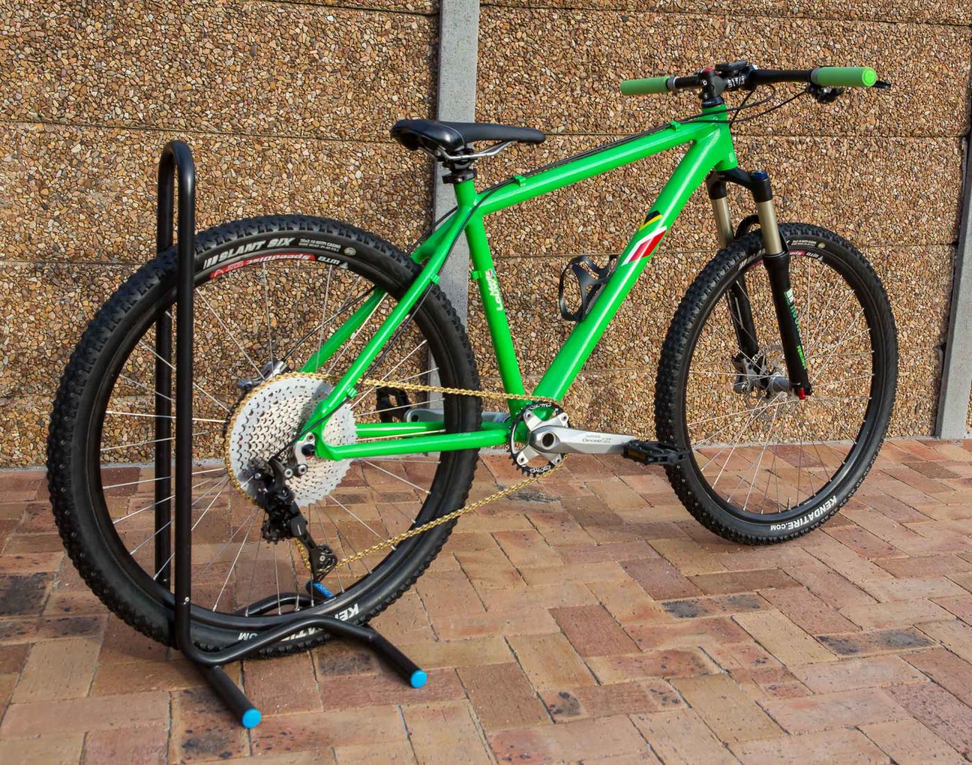

ChrisF Posted May 19, 2019 Share I think 1x11 means upgrading my rear wheel though? (and then obviously shifter and RD....) Maybe I should see how I feel at the end of a month of riding 1x10? I think the 3x9 made me a bit lazy as basically there was a gear for everything! We have just completed the upgrade from 3x9 to 1x11. As it was a Shimano freehub, I was able to slip on the 11 speed Sunrace To ensure a nice wide range we opted for the 11x50 Sunrace cassette. It also meant getting a new shifter and derailure. Cheapest would have been an upgrade kit, but my local bike shop advised me to get the Shimano XT shifter and derailure, paired with the Sunrace cassette. It was only a few rand more expensive. We were advised to keep the chain as long as possible, so that the hanger just clears when on the small gear at the back - Worth noting (as in the last picture) that on the very large cogg the hanger is NOT stretched far forward .... try to avoid excessive strain on the hanger .... It WORKS very nicely It took some handtools and elbow-grease to finish off the 3x crank to fit the single ring neatly ... And this is what the final product looks like Edited May 19, 2019 by ChrisF slickjay007, Wannabe, Jako De Wet and 2 others 5 Link to comment Share on other sites More sharing options...
