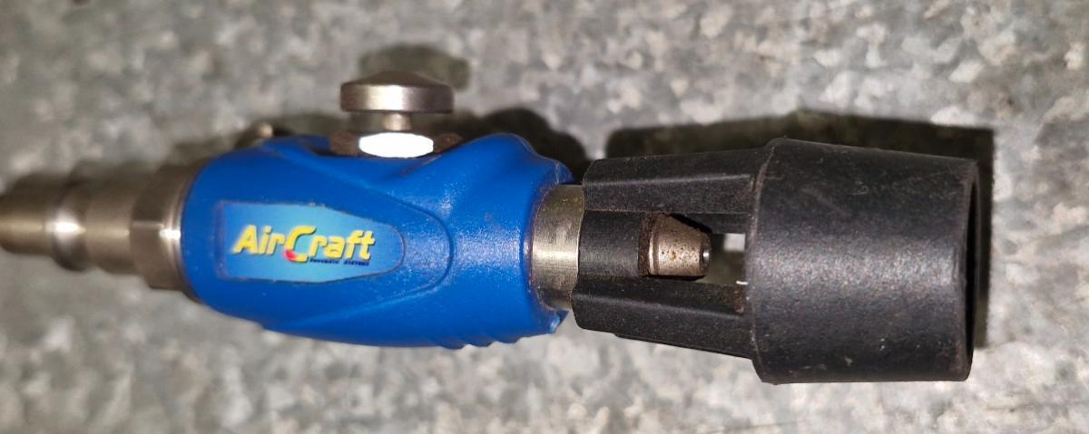

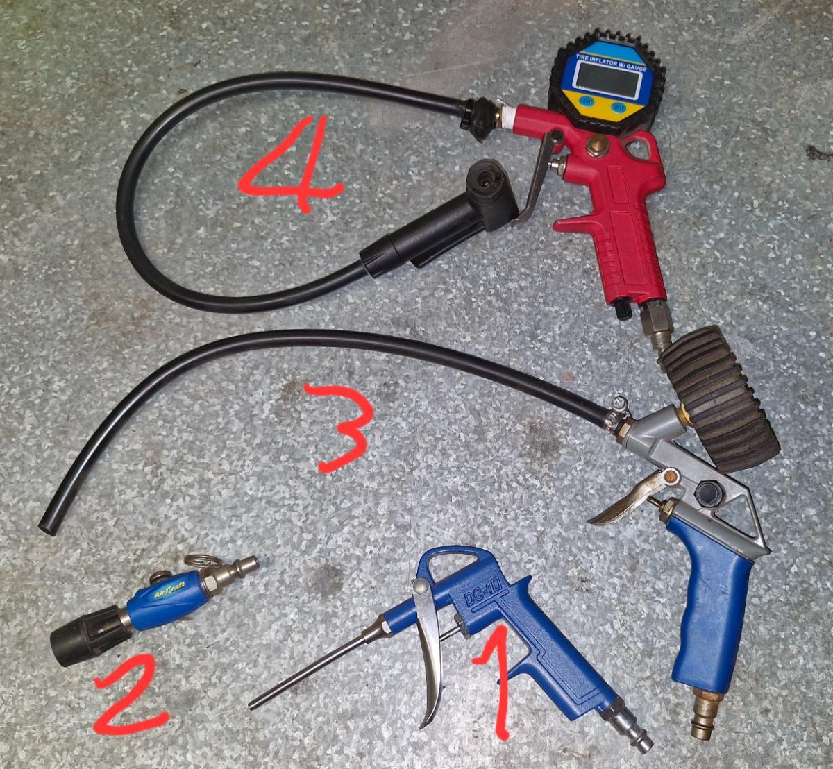

I bought a digital pressure gauge and inflator for a compressor from Addendorf.  Then cut off the standard schreauder fitting.
I used a standard foot pump fitting, and attached that to the Addendorf unit.
Now I can inflate both presta and schreuder from this unit.
