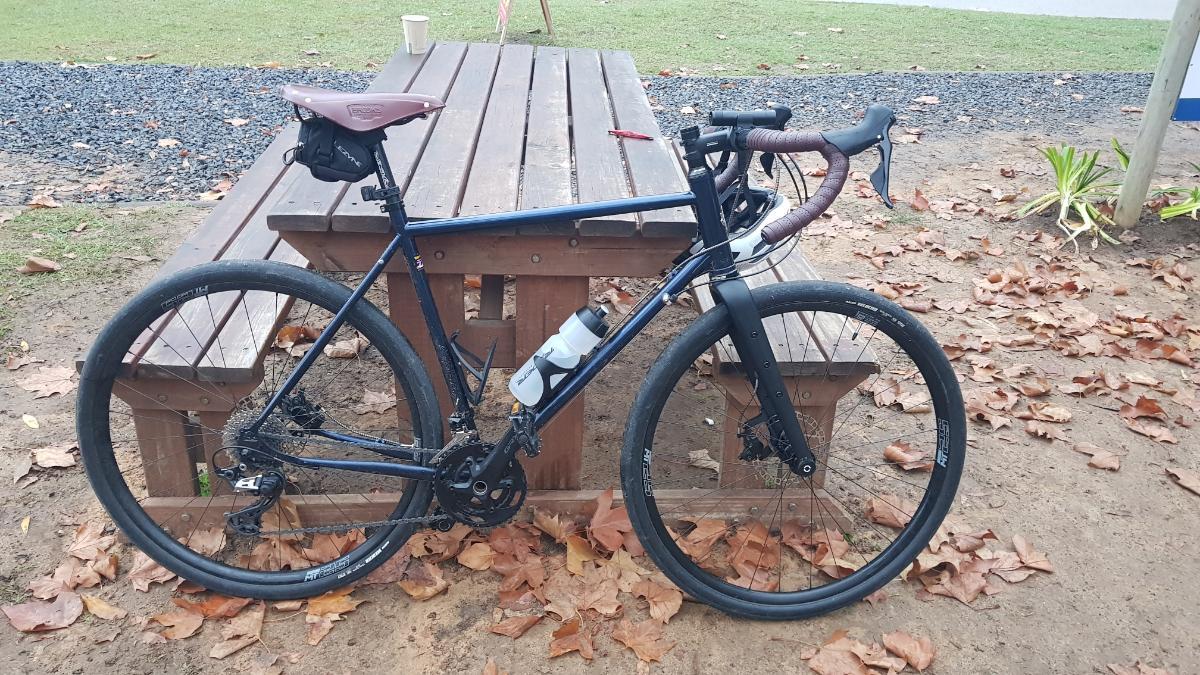

On 5/5/2025 at 4:34 PM, droo said:
You get flat to post adapters. And through axle is far better than QR for disc brakes.
You'll find way more options this way and have a better end product.
Chat to Dave Mercer about forks, he's got access to many options.
Just an update here, I went this route and am very happy. I picked up a Speeder fork from David, a post mount adaptor from Williams bike shop and Thru-axle adaptors plus expander plug for the carbon steerer from Rapide. It was a 1hr job after that and I think it looks great (if you ignore the light and saddlebag). It's also lighter and has the ride quality I was after.
Thanks for the advice.
