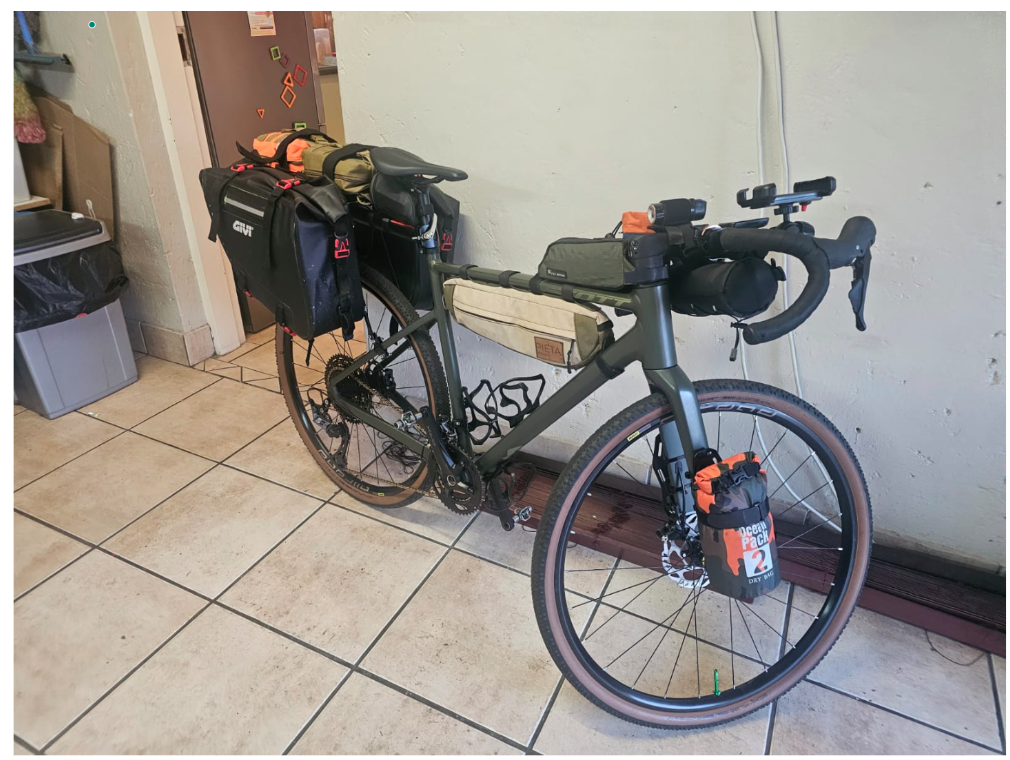

Doing a little trip this weekend. Decided to test the full rig setup. Will let you guys know how it went... (Spot the Moto bags)
Nice compact rig....just what's that up front on the bars. ...and that rear rack...floating? No uprights from axle for stability?
32 minutes ago, capediver said:
I'm struggling to see it, but I'm sure it's there somewhere...how have you stopped the kitchen sink from rattling on corrugations 😉
Sink is rubber...no problems...
