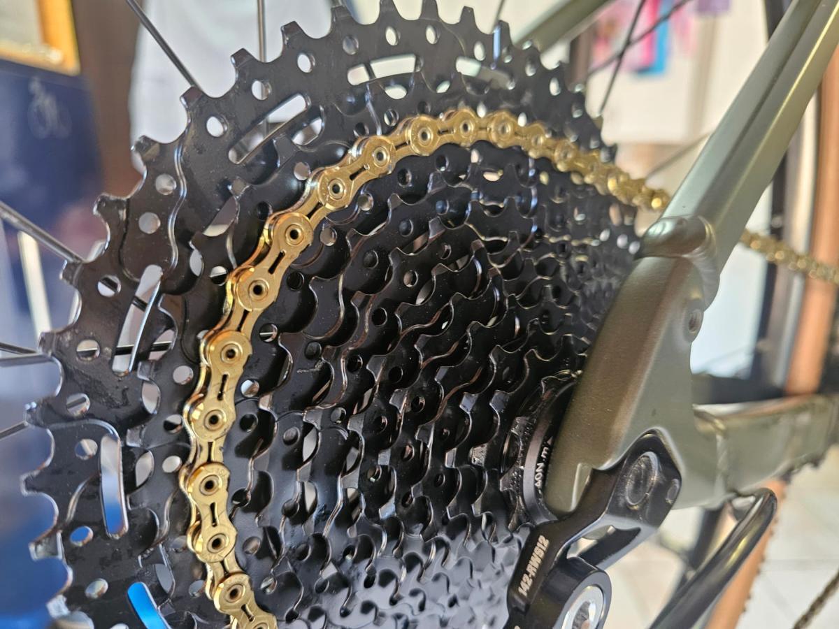

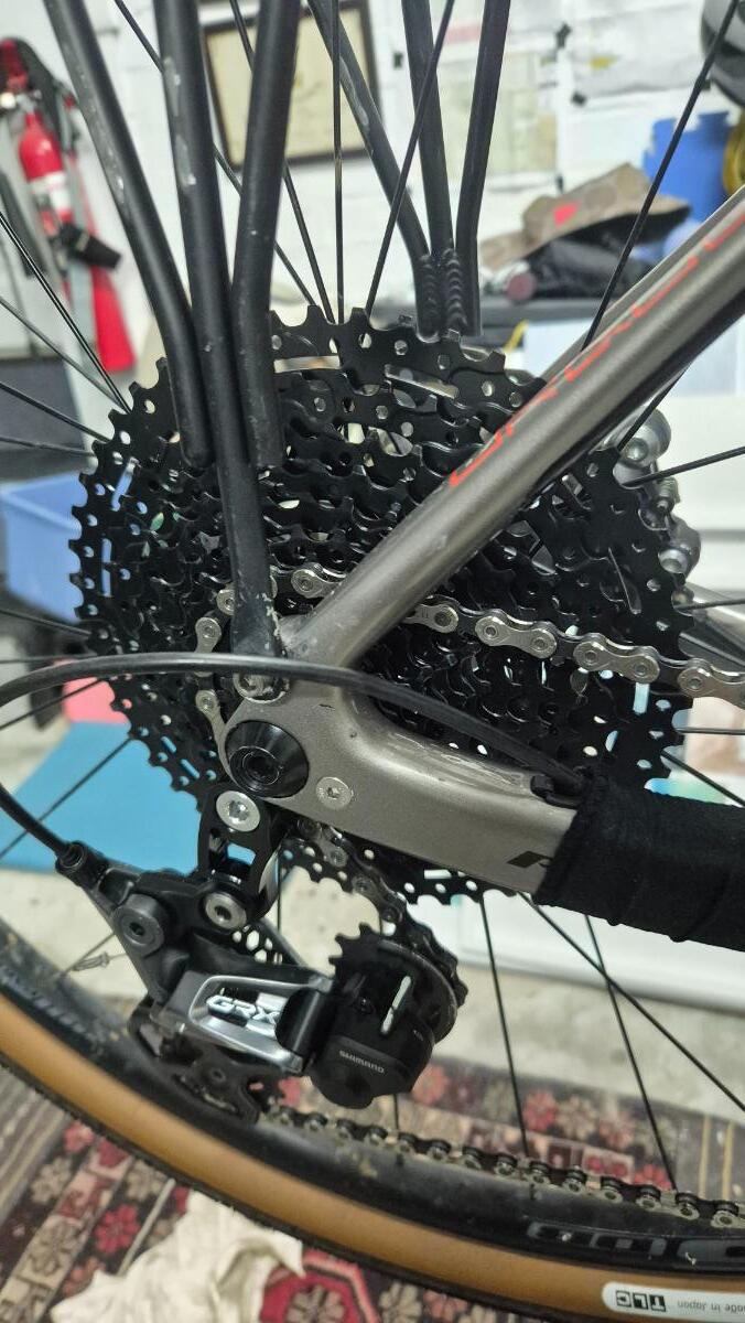

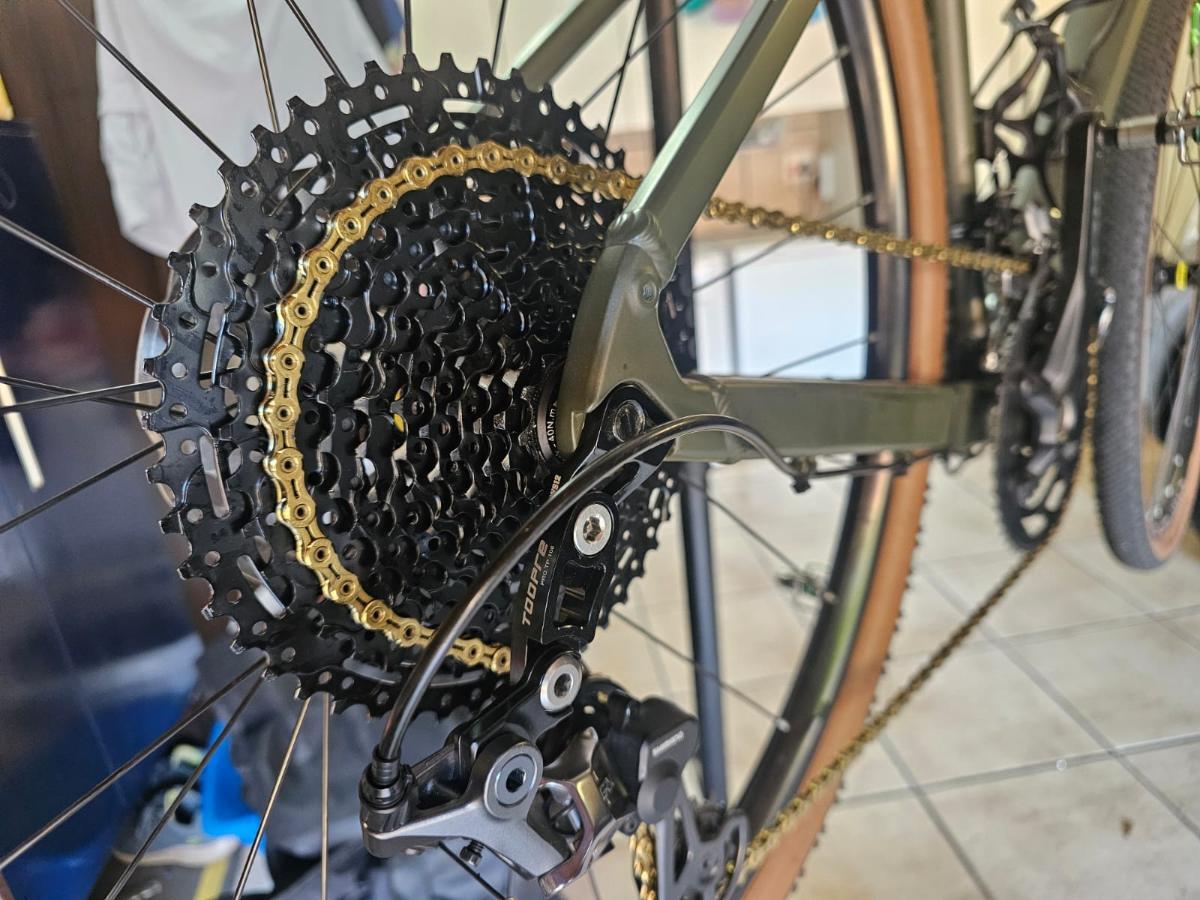

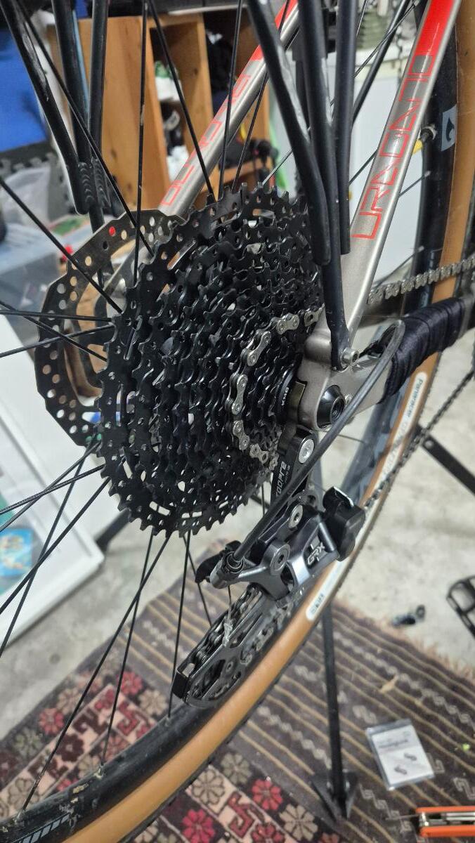

Just out of interest, anybody else out there that did this?
I did not do this to target everyday riding, but bike packing trips and gear on bikes suggest I might want to make it easier for myself...
So, here is some Post pics, quick ride around the block confirmed all working good, just have to keep an eye on cross chaining.
30-40 Crank,
11 - 50 KMC cassette
Toopre extender
Took some adjusting, but all good.

ive got this exact setup and ive done roughly 10k km since the install with absolutely no issues!
Did Suikerbos today... love the range, no issues.
The 50T is bit much, but can see the usefulness.

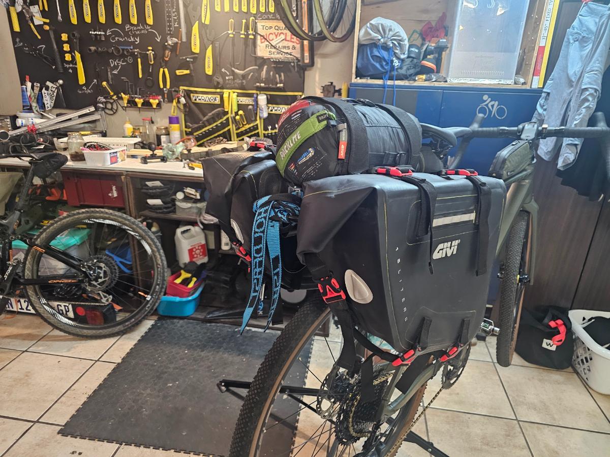

Also.. fitted the Pannier rack and tested the fit with my GIVI Moto bags... must say, looks like it will do the job.

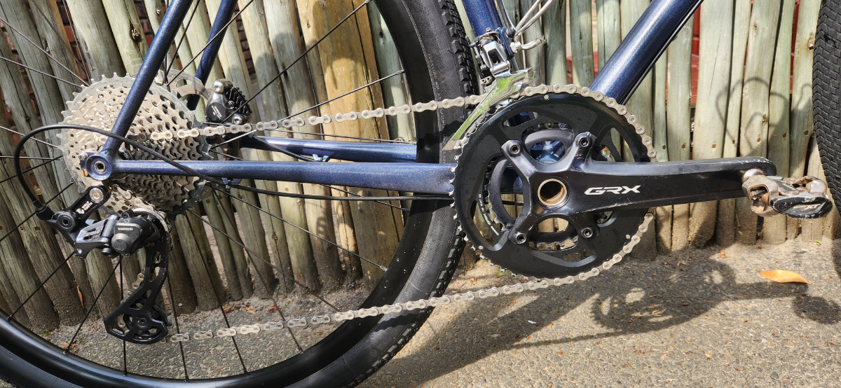

Hi, can you detail your conversion please...
I want to do the same for bikepacking, I currently have:
Crank: Shimano GRX RX600-11,46-30T
Rear derailleur:  GRX RX810 34T MAX
11-34 cassettte
Edited by capediver
11-34 cassettte
Hi,
The conversion is actually easy.
But, I did need 3 things.
1. CASSETTE KMC CS11S 11-50 HG - Evobikes https://share.google/fDCWpXQdTegAQa5fg
2. New 11spd chain. I got the 11spd SL from KMC.
3. Hanger extender. This was a bit of a question mark as I couldn't get the Goatlink. (More often mentioned).
So I got a Chinese (?) Toopre 36 -52 range.
Toopre Bicycle Derailleur Cassette Extender 34-52T
https://www.takealot.com/toopre-bicycle-derailleur-cassette-extender-34-52t/PLID94410445

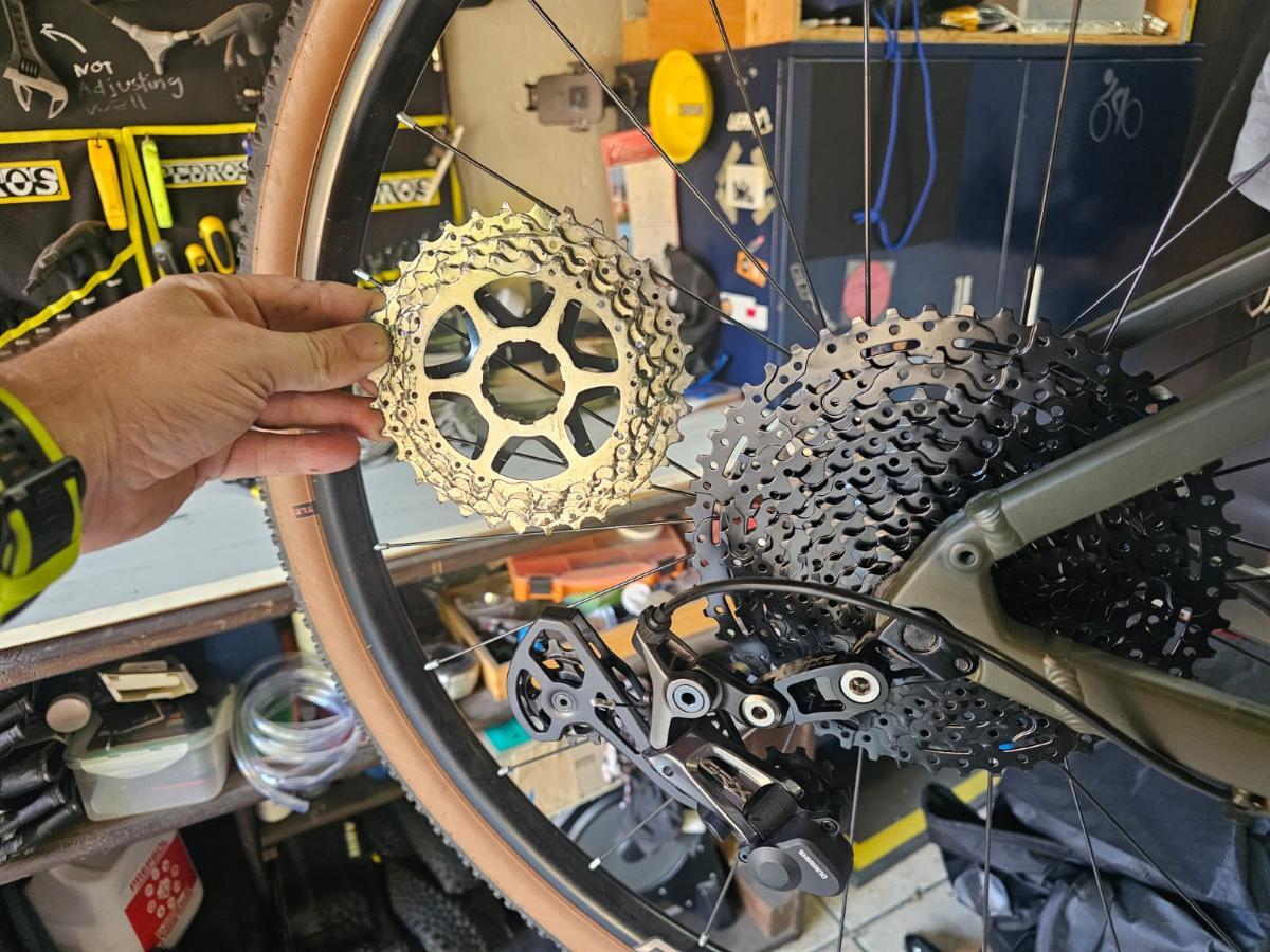

Removed the old cassette, fitted the new one.
The chain... measured the new chain, max rear to max front... and the chain, out of the box was actually on limit.
I choose to do the M on M method as to minimize risk of rear mech pull.
Surprisingly I had some good leeway with the B screw adjustment. If you are unfamiliar with this, check on the Parktool YouTube channel, nice explanation there.
My mech upper limit screw had some adjustment, but you can check movement yourself.
Drive the mech to max with your hand, press the body inwards with your thumb, and pedal. You will see if it reach or is hesitant. If you push the chain off, adjust the reach to less.
Cable tention on mine, took up 1.5 turns.
The more tricky part...
The extender adjustment... this might take some trail and error... i found that full reach forward, adjust B screw on 51t and it was set.
Indexing is not the smoothest in the world, but it works. You have considerable spacing on the higher ranges(top pulley wheel to cassette), but, keep in mind cross chaining, and you should be good.
Don't do Small Chainring - 11T... you will see why. I adjusted B for some slack, but keep the focus on the 51T spacing.
I also have the 810 GRX Mech.
All in my conversion was about R 1 800.
I actually found the KMC cassette alast year on Takealot, think it was R 880 on special. See they have one for R 995.
If you struggle, I would gladly do the conversion for you, but I think Pretoria is a bit far from you 😀
You can also send me a DM and I can walk you through the install if needed.

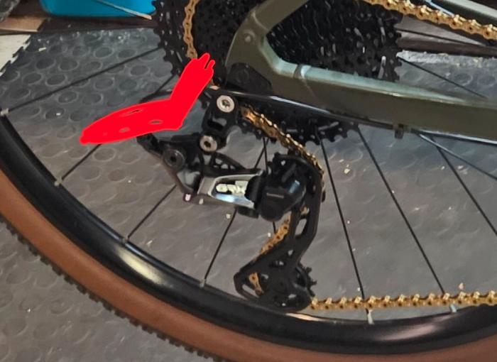

Below, note the down angle and Mech attachment. I think this is the most crucial part.
Excellent, thanks! I saw a few YT vids on this now and it seems pretty straight forward, just getting the chain length and that B screw sorted...I also saw the angle of the extender makes a difference to the shifting...
Will definitely give it a bash to reduce some of this:
