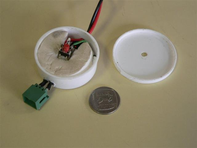

  1. Blfex driver has 5 brightness settings. You can operate it in 5 level mode or duo mode (2 setting). For duo mode you can choose any of the 5 levels for the 2 you use. No problem dimming. But who needs to dim off-road? At 680mA load current at full blast (level 5) the theoretical run time from 2200mAh is more than 3 hours (still need to test the actual run time from this battery). PS: It has been too wet in the Western Cape to mow the lawn, and when the weather is good, I grab the opportunity to go for a dryer ride!
