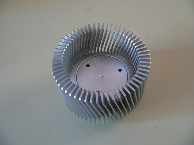

  20. I found this heat sink in an old PC, Total over kill for 3 x 1W Luxeons driven at 550mA, but as you can see the tri-lens fits inside so nicely it just has to be done. (perhaps I can upgrade to 3W Luxeons later). So LED light version 2 will be attempted soon... Mrs mountain_lion has taken possession of the first set, so I need another for myself anyway...

  22. Here is my LED light after some time spent in my dad's garage: The guts: 8 x NiMH AA powering a 1000mA Buckpuck 3021 LED driver, soldered onto vero board with dimming resistor, 3 position toggle switch (off, high, dim) & connector for the LED wiring. The switch has a rubber cover and is mounted on the handlebar with a piece of inner tube. The driver board is also covered by inner tube for electrical isolation and protection against the elements. Batteries and driver are mounted on the bicycle frame in a pouch with velcro strap. I used an old PC CPU heatsink to mount the LEDs on. The heatsink was machined on a lathe to be a tight fit in a section of 50mm PVC pipe. The lens is held in place with a PVC coupling which was cut down on the lathe. 3x 1W Luxeon emmiters: The assembled light, which is attached to the bike stem with an old LED flasher mount: I will take some photos of the light mounted on the bike in day light and post later.
