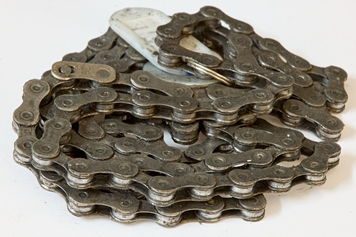

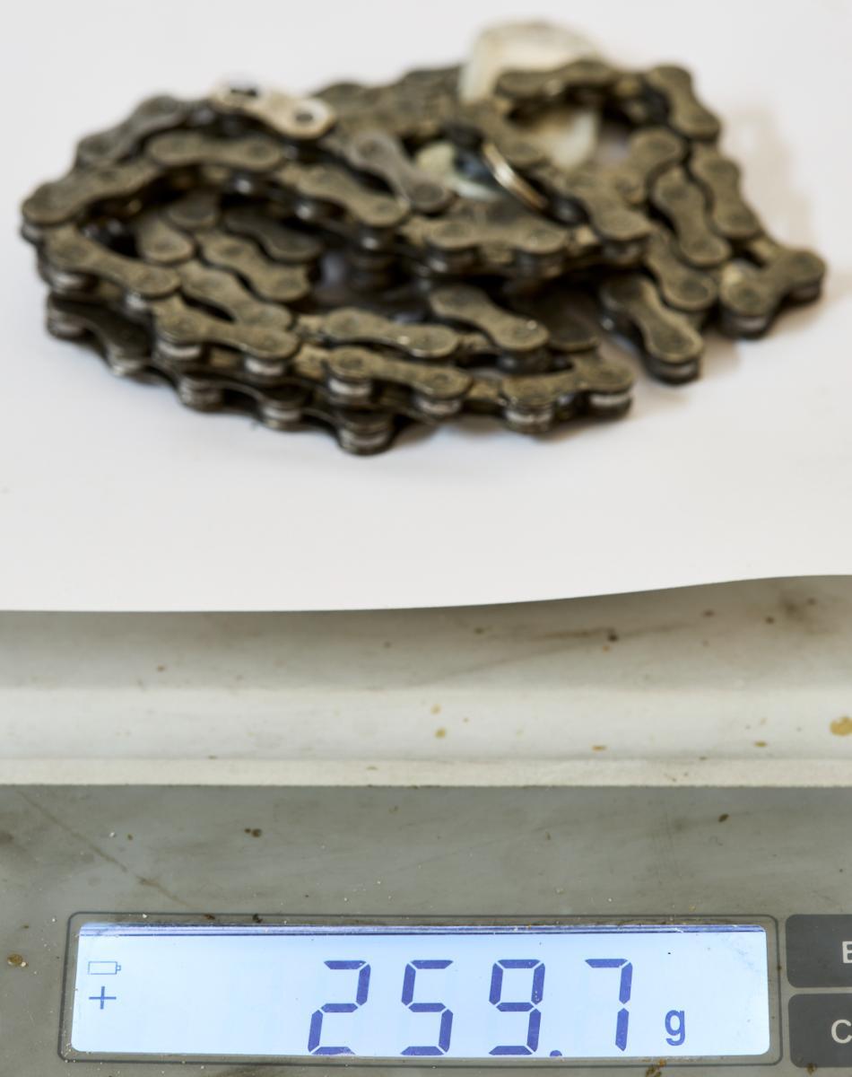

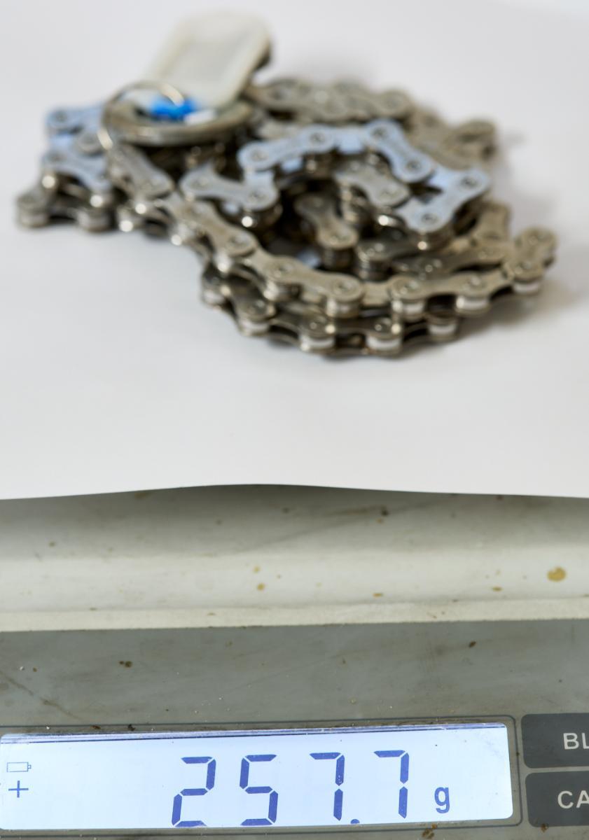

  3. Expected Waxed Chain Longevity & Common Issues In dry conditions, you should be getting closer to 500 km of use on a mountain bike from a properly waxed chain. If you're experiencing significantly lower mileage, there are a few likely causes: Chain Not Thoroughly Cleaned Before Waxing The most common reason for reduced performance is an improperly cleaned chain prior to waxing. It's essential that the chain is not only clean on the outside but also completely degreased internally. The internal surfaces of the chain – inside the rollers and between the pins and plates – are the most critical areas for wax penetration. Any residual factory grease or lubricant can prevent proper wax adhesion, severely compromising longevity. Inferior Wax Product Not all chain waxes are created equal. Some budget or low-performance waxes may lack the film strength, lubricity, or durability needed for high-mileage use, especially in abrasive off-road conditions. For best results, use a high-quality wax designed specifically for bicycle drivetrains, ideally infused with a solid lubricant like tungsten disulfide . Incorrect Waxing Technique Even with a clean chain and good wax, the process must be performed correctly. Here are key steps to ensure optimal waxing: The chain must be completely dry before entering the wax pot. Any residual moisture will interfere with wax bonding. Once submerged, agitate the chain thoroughly to dislodge trapped air bubbles and ensure full wax penetration into the chain internals. Allow the chain to remain in the molten wax until it has reached the same temperature as the wax. This ensures full saturation. When removing the chain, let it cool and set completely before installation. This allows the wax to form a durable film on and inside the chain. If you're still unsure about your results or would like detailed guidance on cleaning, waxing, or product recommendations, feel free to reach out. I'm available via: 📞 082 491 0684 📧 shawn@mtbsouthafrica.co.za Happy riding, Shawn MTB South Africa

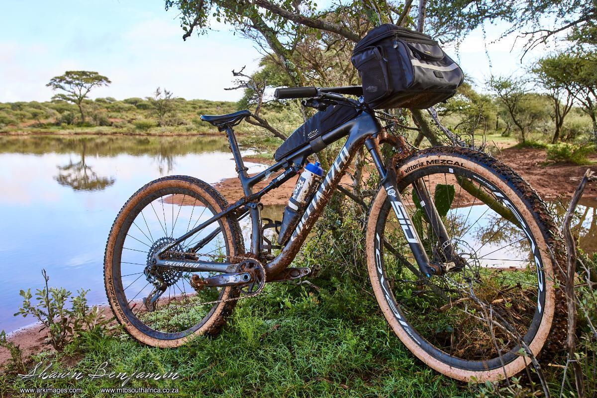

  7. Enduro Wax – My Long-Term Test I’ve been testing our product Enduro Wax, a locally made hot-dip chain wax from Cape Town, since 2 August 2023 on my Specialized MTB. To date (17 June 2025), I’ve clocked up 29033 km with 316226 m of climbing, including events like the 2023 Munga, through all conditions—dust, mud, rain, and temps up to 45°C. From the start, I used two chains, rotating every ~450 km, and here’s the key point: I’m still running the original drivetrain—same two chains, cassette, and chainrings—with zero replacements. The drivetrain is still running smoothly and quietly, with no shifting issues. Dry rides: up to 500 km per wax. Wet/muddy rides: Performance is still far ahead of drip lubes, but reapplication intervals depend on how gritty or contaminated the water is—the dirtier it gets, the sooner you’ll need to re-wax. Cleanup is minimal—dirt doesn’t stick. I’m on track to reach 30,000 km on the full original setup, and I’ll keep you posted on how far it goes before any signs of failure appear. More and more riders are switching to Enduro Wax and giving us great feedback Happy to answer any questions if you're considering switching to hot-dip waxing.
