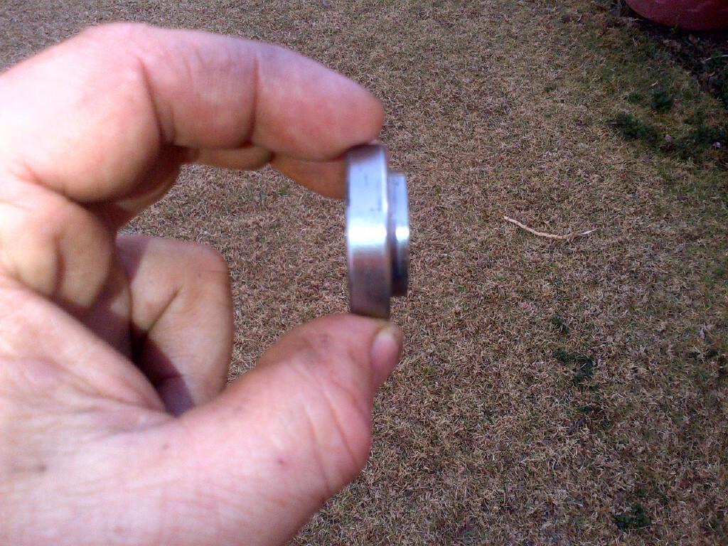

Had some creaking on the crank/BB so I decided to take the BB apart and clean it up, add some new grease etc. But now I cant remember which way this bearing goes into the cup on the non-drive side! Does the smaller ring that sticks out go into the BB or does it face outwards towards the crank arm?
Edited by Mojoman
I have had it in with the smaller piece that sticks out in towards the BB but then when I tighten everything up there is alot of resistance on the crank when I turn it by hand?
I rebuilt mine last week. That nasty bearing def goes in with the smaller diameter first. Else the sir-clip on the outside will not be flush/tight against the bearing.
Have you maybe not got that plastic tube that goes between the 2 BB cups the wrong way round. It is drive / non drive side specific. That could cause the cup not to turn all the way flush against the frame.
Put it all together and it feels quite tight but I have read thats normal due to the seals.
