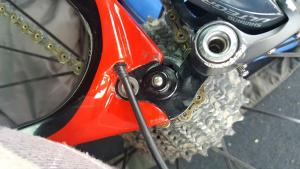

Malpiet Posted January 26, 2017 Share Can you post a pic of the hanger? Sometimes with a slight mode another manufacturer hanger could work. Alternatively a engineering shop can make you one if you cant come rite anywhere. Link to comment Share on other sites More sharing options...
Eon du Plessis Posted January 27, 2017 Share Can you post a pic of the hanger? Sometimes with a slight mode another manufacturer hanger could work. Alternatively a engineering shop can make you one if you cant come rite anywhere.Will do. The bike is currently at a shop but I'll take a pic when I pick it up. Link to comment Share on other sites More sharing options...

Eon du Plessis Posted January 28, 2017 Share Right, image attached. You can see why the hanger is slightly bent. Thank you illegal-u-turn-performing-idiot. Wish the hanger was the least of the damage, but fortunately there is insurance. So I went to Solomons and they were out of a generic one similar to this. They are receiving new ones next week though.Apparently, if it's not an exact match, you can just file down the difference. I don't really see a problem with that as it's probably similar to what an engineering shop would do. An exact fit is still first prize, obviously. Link to comment Share on other sites More sharing options...
