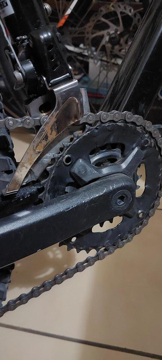

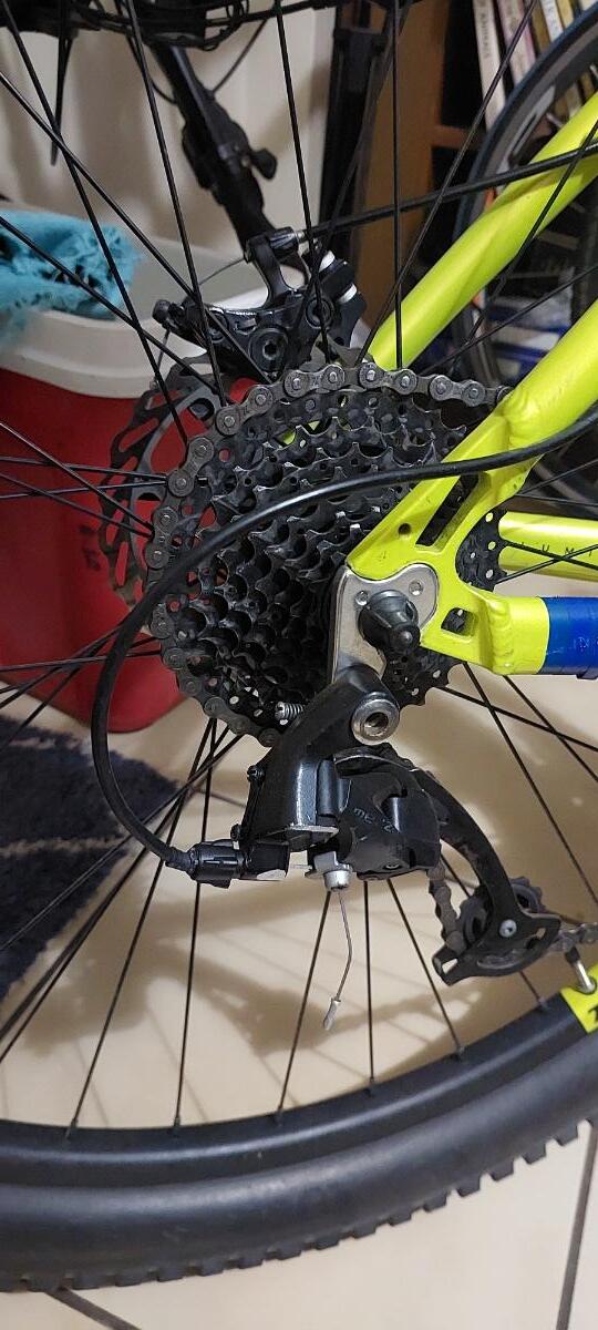

What groupset is on the bike?
How many kilometers have the groupset done?
Perhaps post a picture of the chain and cassette.
DJuice, thanks for the quick response,  i have no idea on the kilometers done, my group set is 2x8, tried to take photos as requested.
Will try and get hold of the persons you recommend. Thanks.

You can replace everything as per what  @RobynE 🚵‍♀️ suggested (which is a great suggestion), but, then also include a new freewheel body as your current free wheel body won't take more than a 10 speed. A cheaper option will be:
Leave the bike a 2x8 & only replace the chainrings, chain and cassette. This will set you back less than a grand, here's some links:
https://www.takealot.com/arfast-6-7-8-speed-bike-chain-116-links-silver-electroplated-bic/PLID101189851
https://www.takealot.com/sunshine-sz-8-speed-11-36t-silver-mtb-bicycle-cassette-hg-hub/PLID93384858
This.
Also won't hurt to get in touch with the LBS folk mentioned.
Going the 1x12 route is good, but is going to end up costing near enough the value of the bike itself. If you do scale up, Shimano Cues is worth a look.
