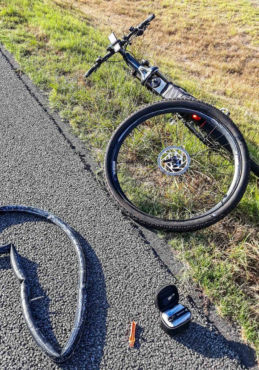

This was me on Sunday ...
First time in many many years .... but never say never ... 🤣
Sure you will pick up these skills very quickly.
May well be a Hubber around the corner from you that can show you how to ....
