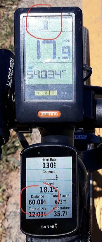

My Darrvin has 500W.h batteries.  I used about 400W.h for 60km and 670m elevation, including a decent head wind for about 20km.
Thus, even my buggered knees should be able to complete the CTCT with a 800W.h battery 👍👍
Disclaimer .... I have seen what the South-Easter can do to battery range !!  And we know the statistics of wind and this event ....

ONCE ..... During my first year I twice rode the battery fully down.  Once it actually shut down 800m from home.  5 000km later the battery is still at 95% health according to the app, practically it still performs properly.
Did they program the shut down to be at a safe level ?
Was I just lucky ?
I now try to not take the batteries below 20% SOC, 10% as a minimum.
The pic in the previous post .... I could have just made it home on the remaining charge.  With two bars left I stopped and swopped out 👍  o well .... will see in a few years if it was worth the effort 😋
