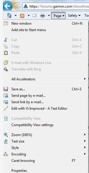

@WR.1 you do not say what browser you are using?
As I said before there are known compatibility issues with IE 9.
What you need to do: (if you using IE 9) (from another forum)
Log into Garmin Connect
Click on Page in the menu bar
and select Compatibility View
