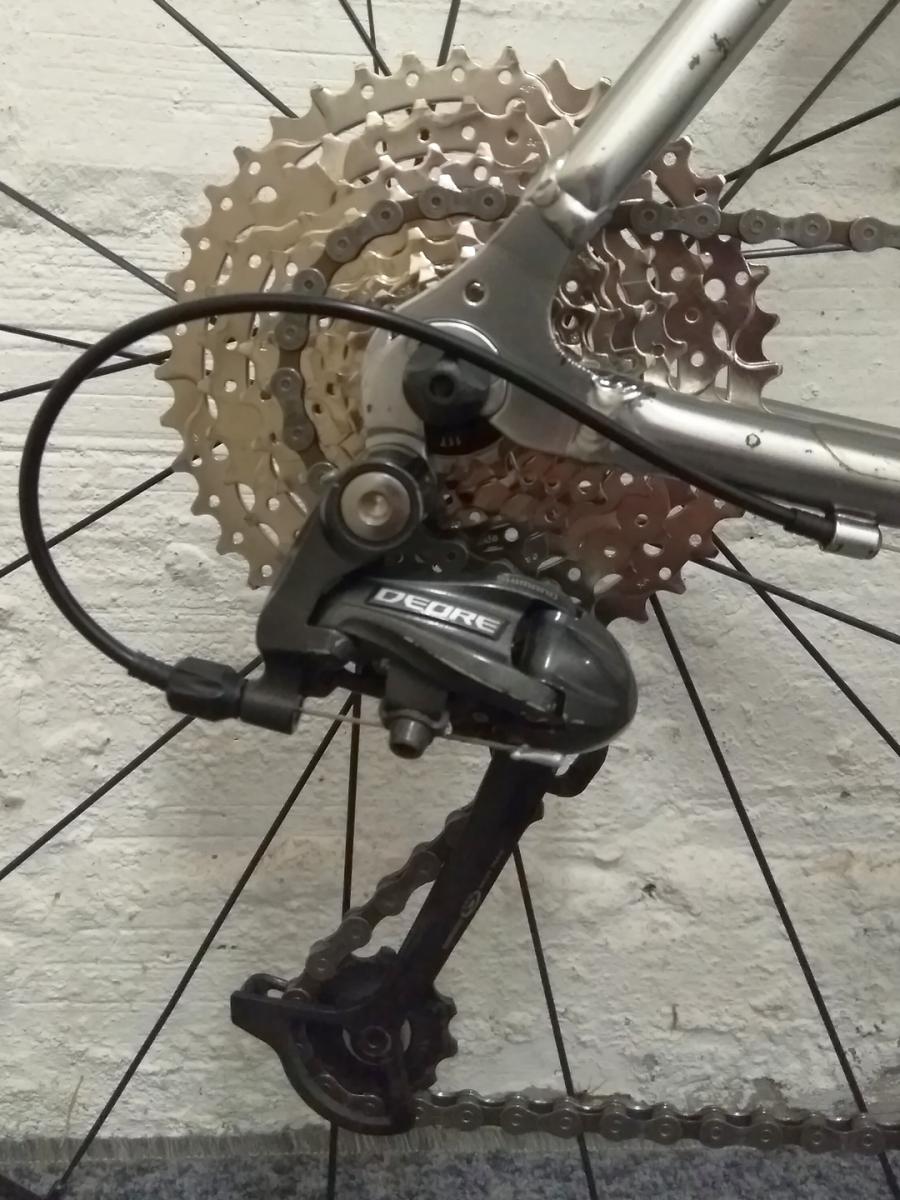

Update, now on 1x9  :thumbup:
The old 1x8 served me well, most significant rides I did on it was two double Argus' (2016 / 2018) and two One tonners. When I learned that 9 speed also shares the same cable pull on road STI as on MTB setups I ordered some "MicroShift" STI levers from Aliexpress and bought a 11t-40t Sunrace cassette at a local bikeshop.
Well it all came together recently so now my 2002 Giant OCR3 has a FSA crank with single 50t Deckas NarrowWide chainring, Shimano HG93 9 speed chain,  Sunrace CSM980 11t-40t cassette and the Deore 9 speed derailleur I fitted back in 2015.
Will be trying it out in the next week or so. Looks like it will be a vast improvement over the old 11t-34t 8speed I had.

Does the 9 speed Deore rear derailleur handle the 40t sprocket without any issues? Did you have to use a longer B-screw?
Works fine, stock B-screw. I have the 10speed Deore M615 on my MTB and it handles 42t with the stock B-screw so these "cheaper" rear derailleurs do go a long way.
