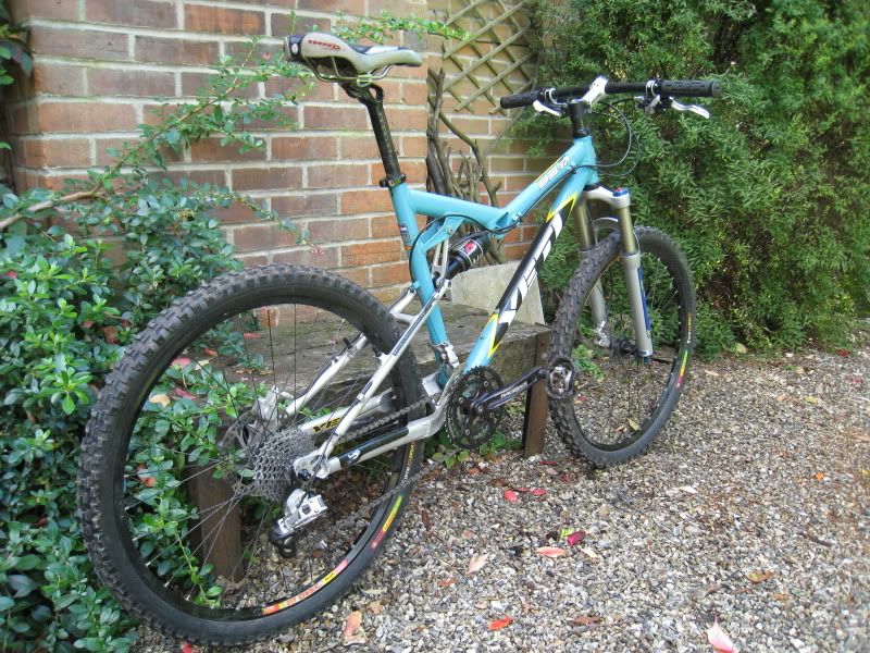

I have an old Yeti ASR-SL, and at the first Bike Fair chatting to the Yeti guys, I mentioned that I hardly (maybe once a year)  ride the bike. One guy suggested converting it to 650b/ 27.5. From the comments above,  I should probably borrow a wheel somewhere and first check clearance then.

 I suppose it depends on the exact model.  I can see it working on this one
http://fcdn.mtbr.com/attachments/yeti/404322d1225388744-super-light-asr-sl-builds-picture-006_resize.jpg
but you might run into trouble here:
http://i19.photobucket.com/albums/b187/wadsy/Yeti%20ASR/Yetietc012.jpg
Slicks on a Yeti :eek:  :eek:

Depends on the bike too. Some frames are already tight with 26x 2.25.
If it's an AM bike generally they will have sufficient clearance for 26 x 2.5 so going 650b shouldn't be a hassle.
On XC frames it's usually very tight
