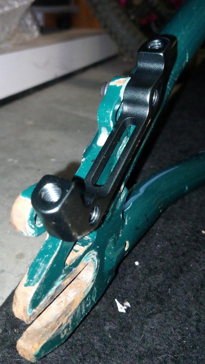

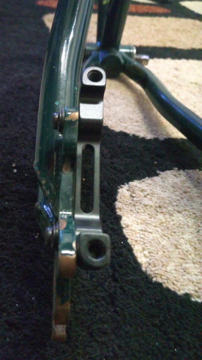

Are all caliper mounts the same width? I am fixing up a GT Ruckus and the Shimano rear caliper mount I fitted is making contact with the rotor. Should I try a different brand of caliper mount or what other options do I have here?

That 6 bolt mount doesn't look standard on that hub and I remember DK going along with BMX parts.

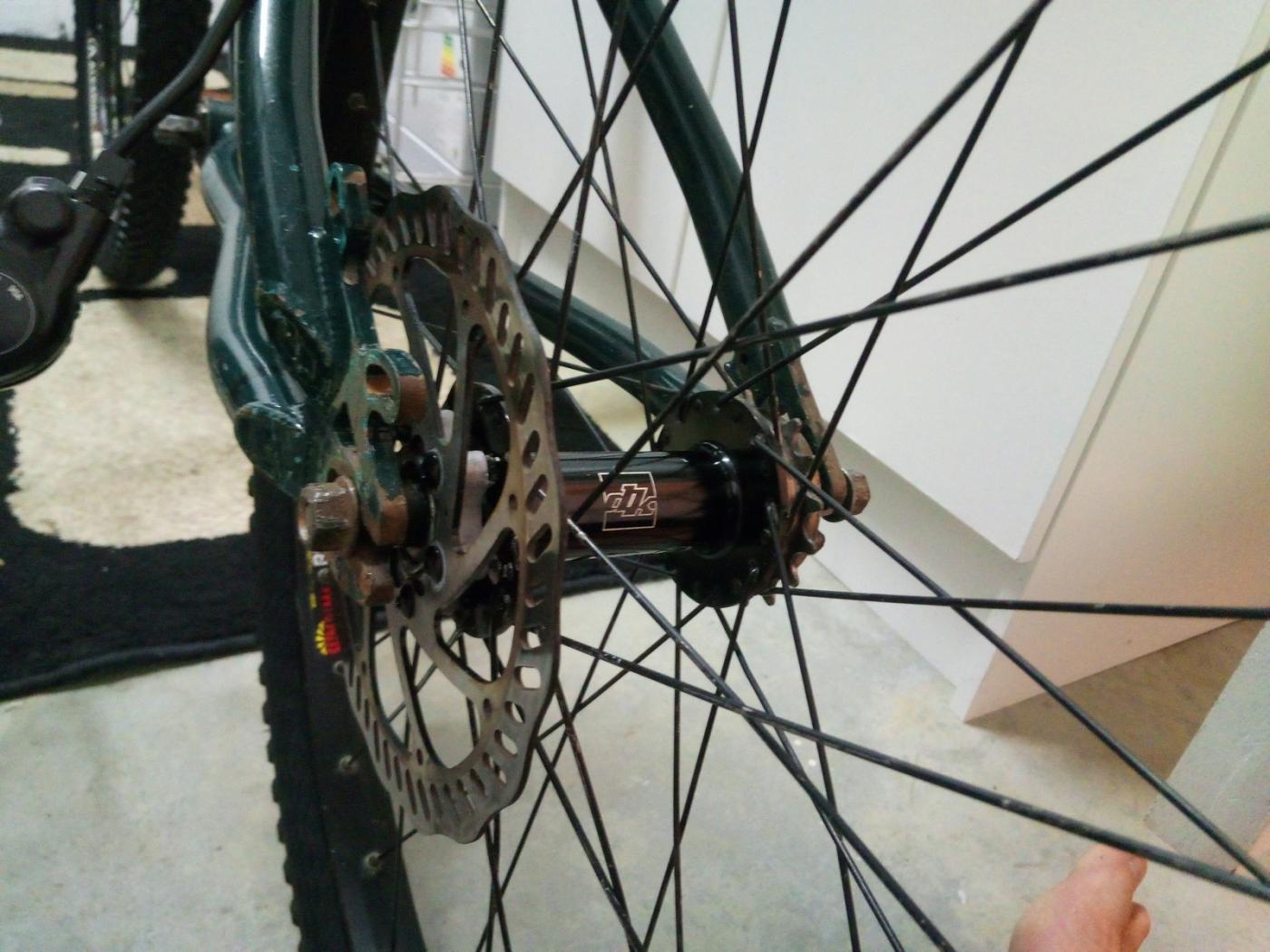

Don't think the wheel needs to be dished. You just need to figure out how the previous guy DIY'ed it. You probably only need to move everything a couple of mm to get the rotor in the calliper?
There is only one size (width) of those adaptors.

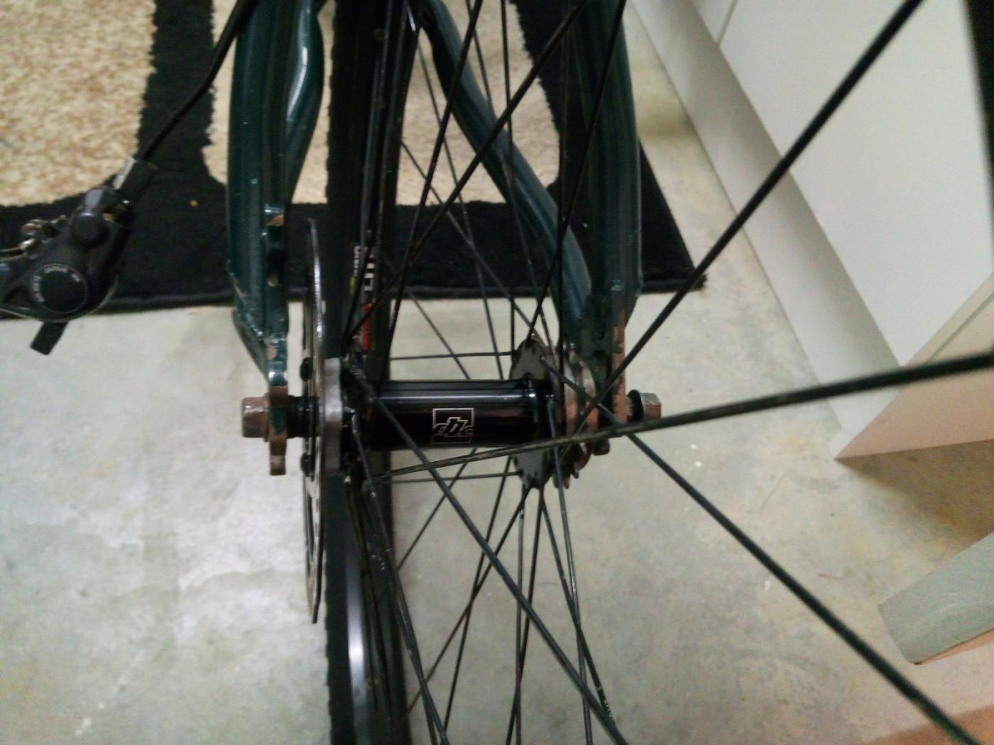

From the limited view of the wheel in the chainstays, the dishing looks okay... don’t think you need to change it.

It's a millimeter or two. I can fit the wheel with the caliper mount and it touches the rotor but does not bend it permanently.
Even if they have to file down or bend the bit on the frame or the 6 bolt mount I don't mind. Just as long as it works. But I am beginning to think the fault lies with the 6 bolt mount, it is a little wider than is needed.
Dishing only changes the position of the rim relative to the hub, so that won't help you.
Depending which side of the disc your caliper is touch...
1. Add a washer or two between the frame and adaptor to shift it in
or
2. Check what spacer washers are fitted to the hub "cup and cone" assembly and move them to the opposite side. Adding a spacer on the left will shift the hub on the axle, affectively moving it the opposite to what 1. would have done.
(Don't add new washers or remove complete as this will mess with the spacing)

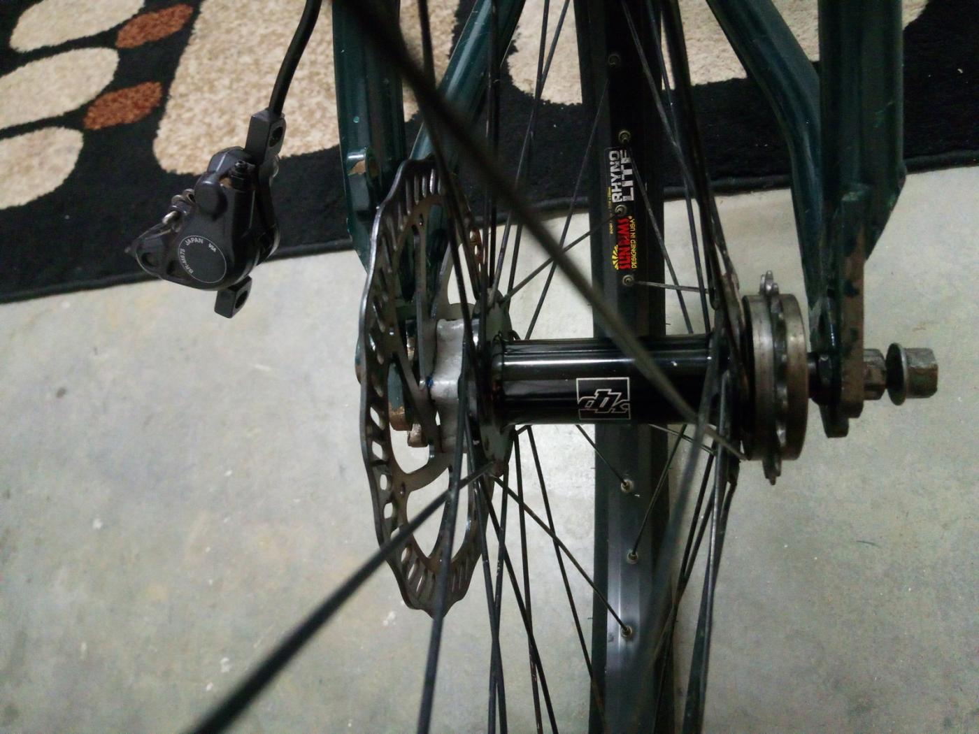

Verify that the Over Lock nut Distance is 135mm. Had the issue with my old dirt jump bike that the hub was only about 130mm with 2 x 2.5mm washers on either side where it mated up with the drop outs.
Had unending **** with rubbing brakes after I got the bike back from one of the bike shops in stellies when they removed the washers. Ended up buying a new hub with the right spacing and it solved my issue.
If it is 135mm then your best bet might be to find the cheapest hub you can (Probably in the classifieds section) and rebuild the wheel. It's not that big a mission and it's going to save you a lot of frustration in the future.

I'm sure you will sort that one out with some clever spacing or a little filing. Just don't bend, as it will make the mounts no longer 90° to the disc.
