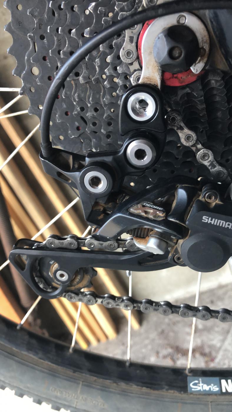

Problem solved. Bought a derailleur hanger extender from Dominic at Summit Bikes for R100.00.
Now running a 10 speed XT rear derailleur (long cage) with a 12 speed Sunrace shifter and 11-50 Sunrace 12 speed cassette with absolute no problems.
