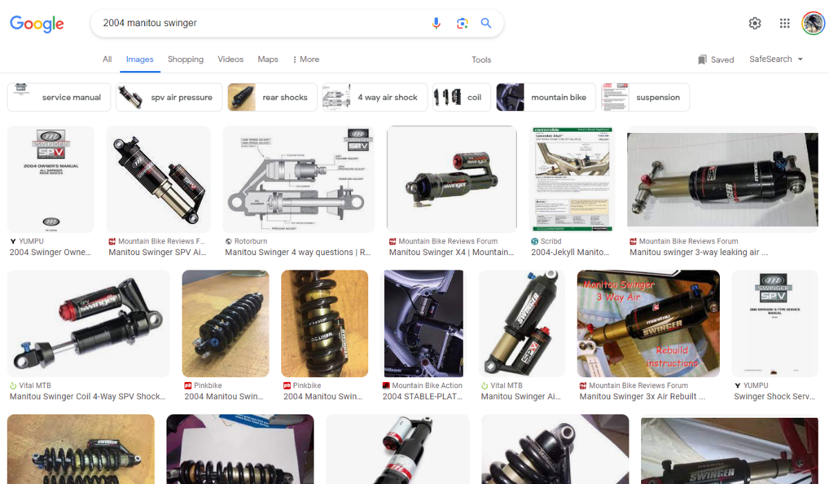

A 2004 manitou swinger will fit !
Please.if anyone has one.please let me.know !
Manitou Swinger (like "Fox Float") is just the general range of rear shocks, which included everything from a air shock with a piggy-back to a coil.
It will have to be the Swinger model specifically made for the Jekyll 800, likely an OEM shock used on different model variants of the Jekyll 800. They probably used the Fox on the upper models and the Manitou on the more budget friendly ones.
Here's a link to the literature on the Swinger specifically used on the Jekyll 800
https://www.cannondale.com/-/media/files/manual-uploads/manuals/2004_jekyll_manitou_rear_shock_set_up_owners_manual_supplement_en.pdf
