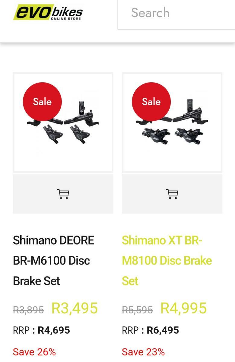

the spares are hard to find and the ballache might not be worth it
Couldn't have said it better myself. Calipers are cheap if you can find a Deore or SLX. But it's holiday time and some folk have more time than spare cash. And others (like me) prefer to fix a thing than throw it away.
The upside of buying a new caliper is that there's a spare piston and seal in the old one if it happens again, or if a mate has the same issue.
