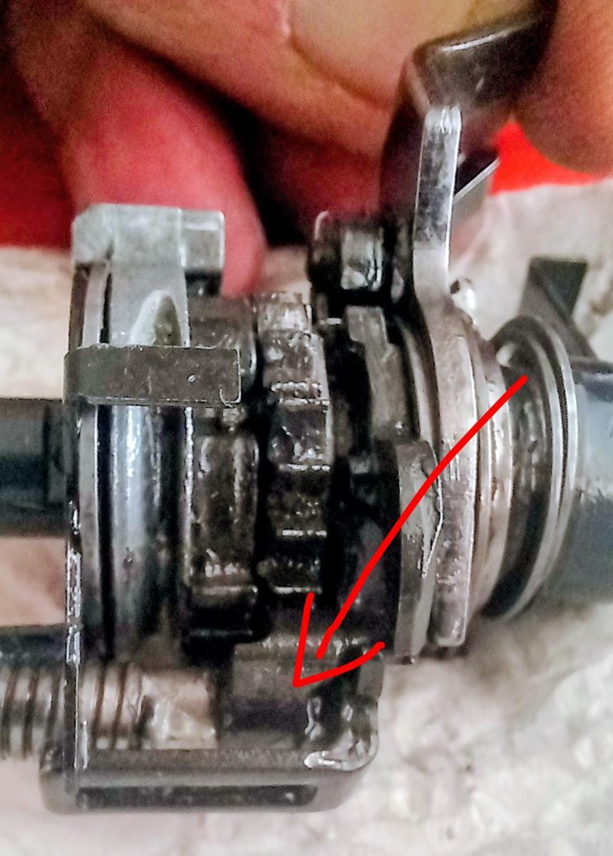

Don't know if anyone else has had this problem .... Shimano 11sp (105 in this case) right shifter gets 'stuck'
If you take the shifter off the bike and hold it upside down it works fine 😒
Shimano shifters are not 'serviceable' IYKYK
Had some time (a whole morning) so 'tore it down', identified where the problem lies, now to find a way to solve it. Have tried a few options, works for a few shifts then stops 😒
Will have another go this morning .... anyone maybe solved it?
Sorted 😎
Using a piece of elastic mind you, how well it will last remains to be seen! Will fit it to a lesser used gravel bike for now and see how it goes 😁
Lost a little grub screw during the fudging about, thank heavens for dremels. Managed to fashion something to work .....
