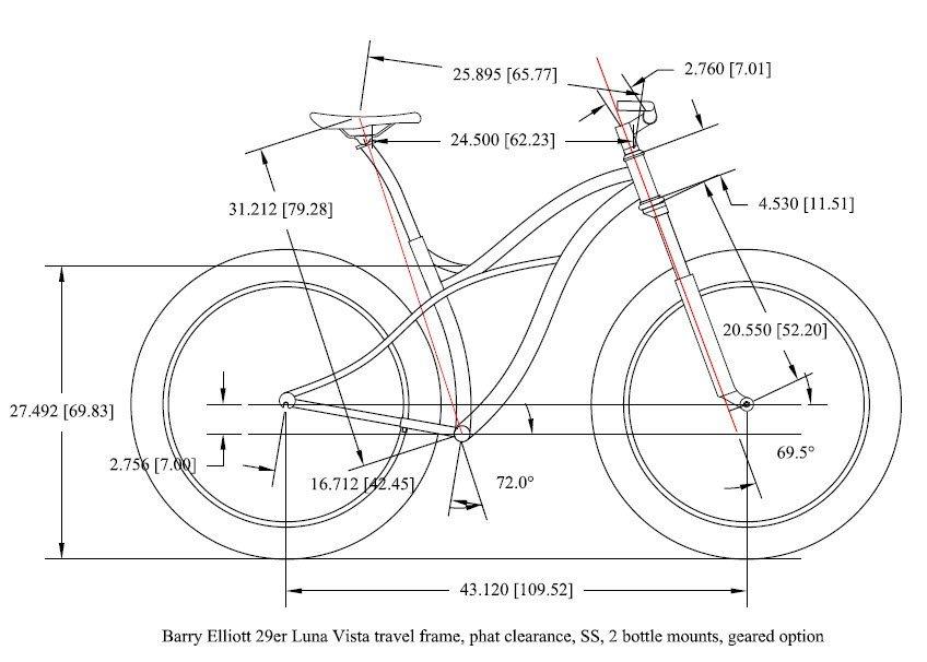

Next rev of drawing attached which I have been working through this last week. Revised numbers and changed fork to RS from Lefty. I really underestimated how hard this would be. When you can have whatever you want it becomes very difficult to choose. Also, very easy to to hung up on the numbers, or a specific one or two, which in themselves do not necessarily a great handling bike make!
When you start throwing in things like front center and mechanical trail into the normal mix of effective top tube, reach, chainstay length, BB drop, standover, etc it starts getting confusing...

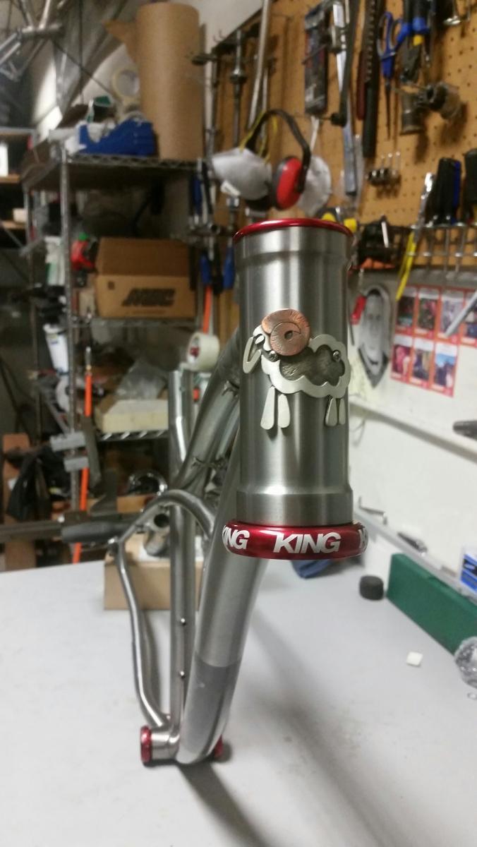

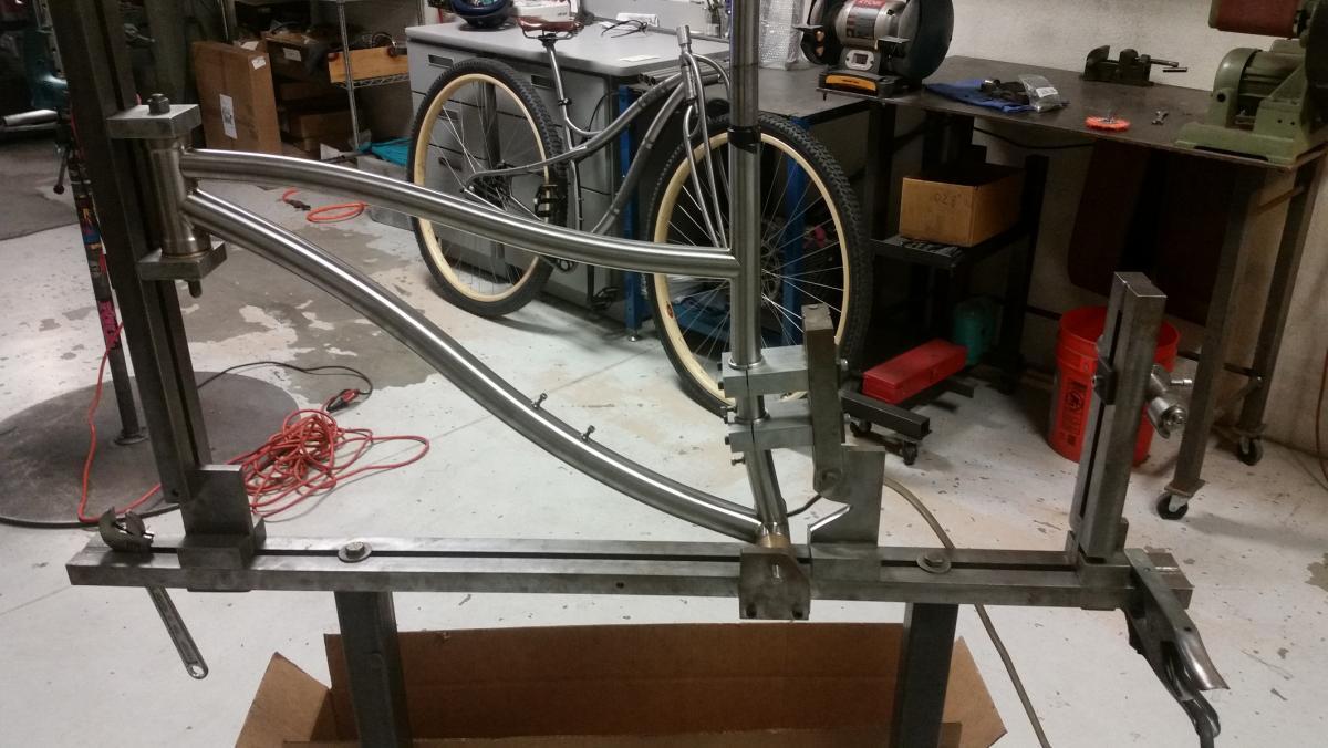

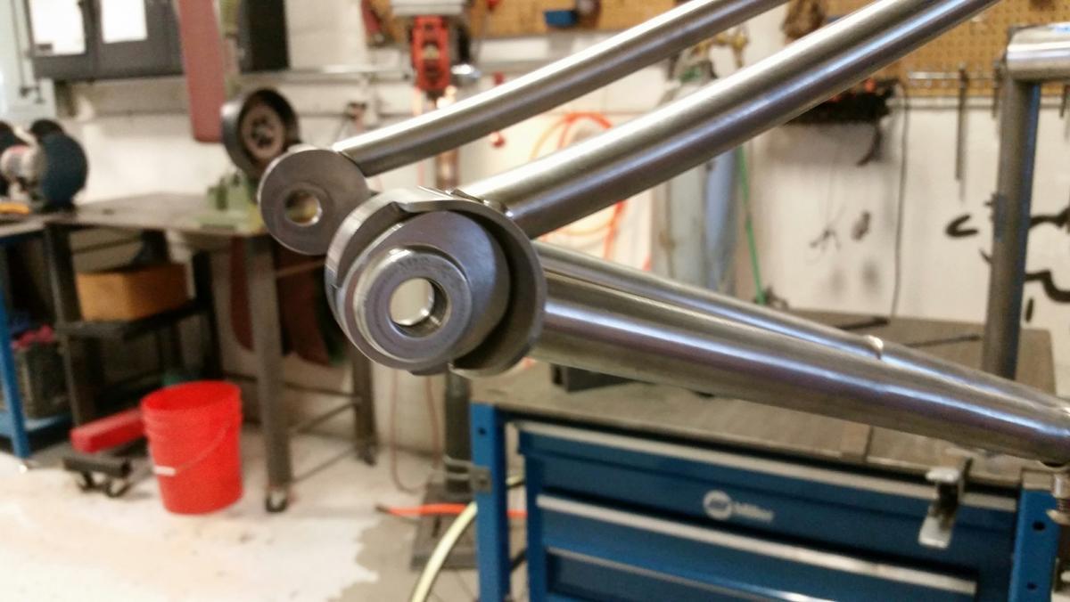

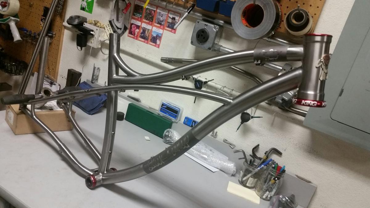

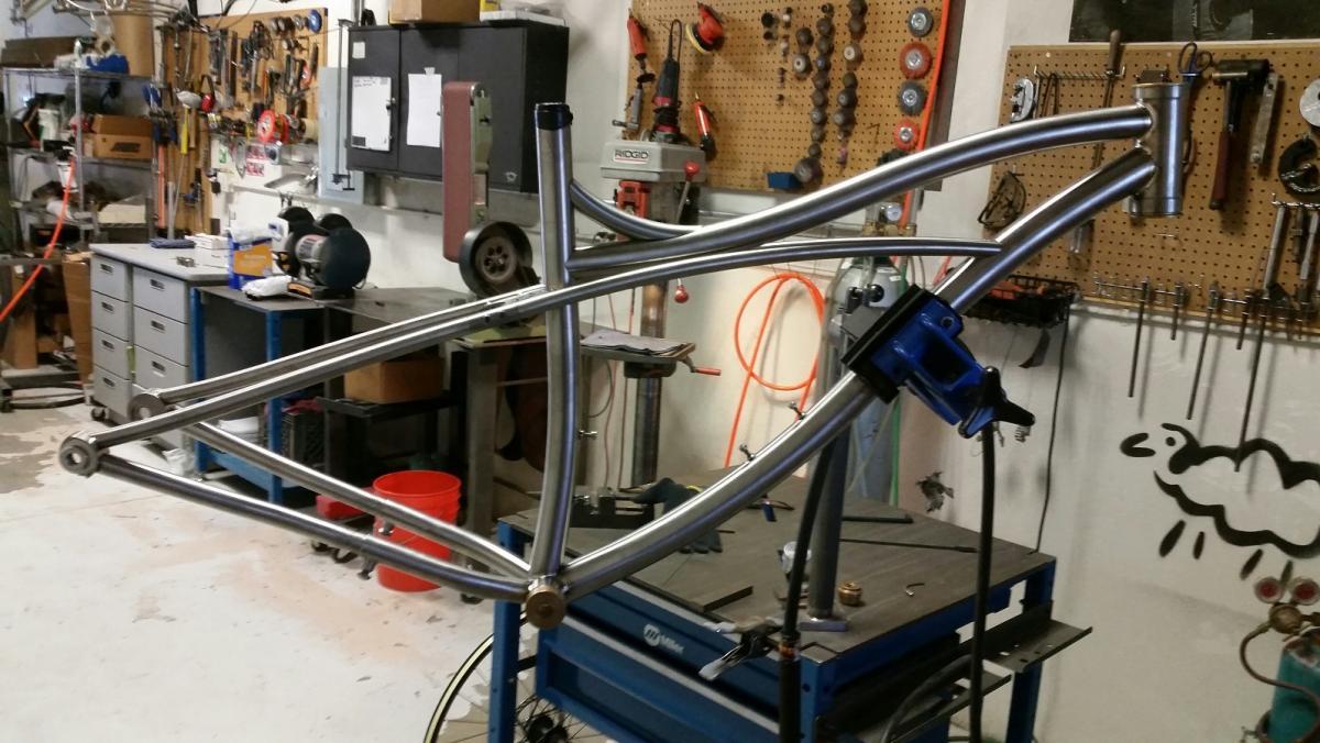

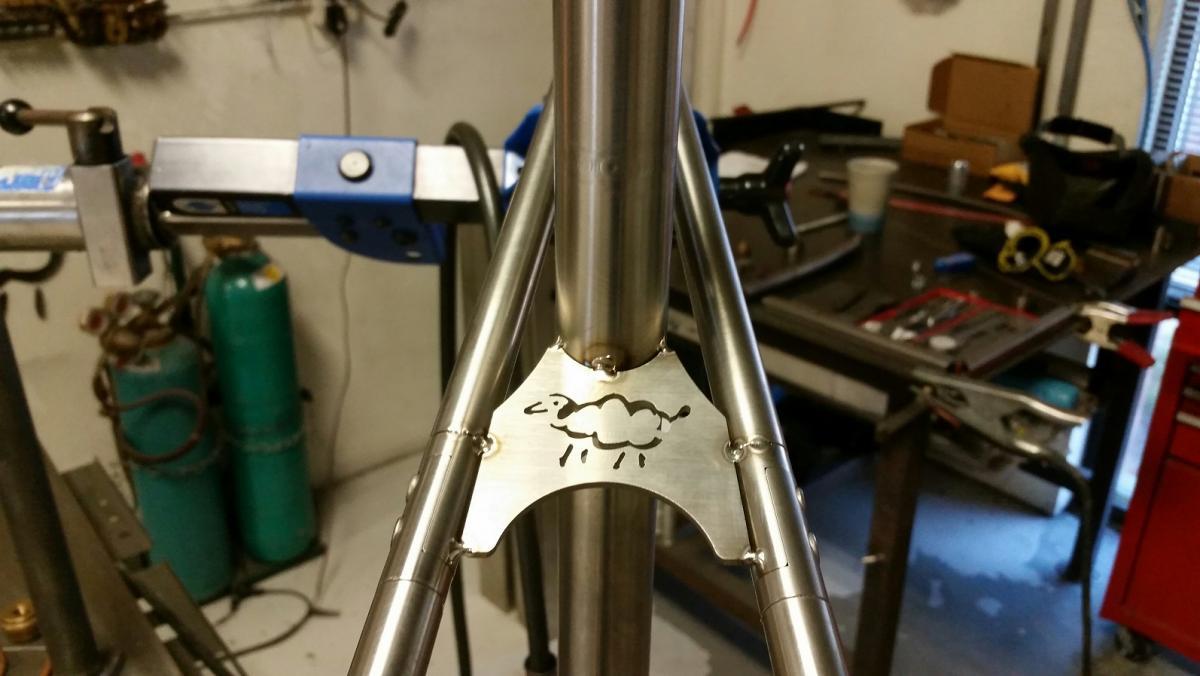

Build post #3: Frame fully welded up, Chris King headset and bottom bracket installed, head badge mounted, media etch completed. Syntace X12 142x12mm rear dropouts. Axle and derailleur hanger is removable. HACS (horizontally adjustable chainstays) can just be seen on the extreme right of the last picture. Very clean SS or geared option.

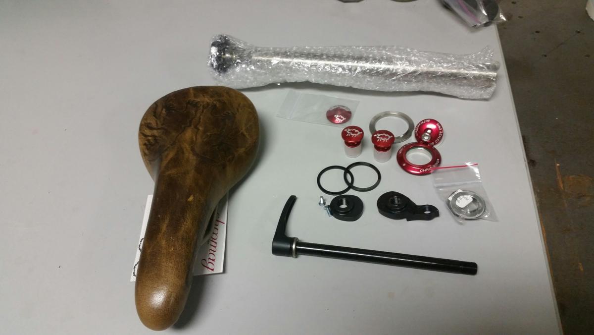

Build post #4: Pics of the juicy little extra bits also on their way. Layback Black Sheep titanium seat post, Chris King red bits and a Cromag Trailmaster Limited in distressed brown leather. Oh and a custom Black Sheep headset top cap and set of bar end plugs. Sweeeeet!!

Nope, 29er only. Standard 73mm BB width and short chainstays 16.7" precludes fat 36" rims and 29+. Did want either, so designed as I wanted. Will build as SS but will convert to gears when the fancy takes me. About a 10min job.
