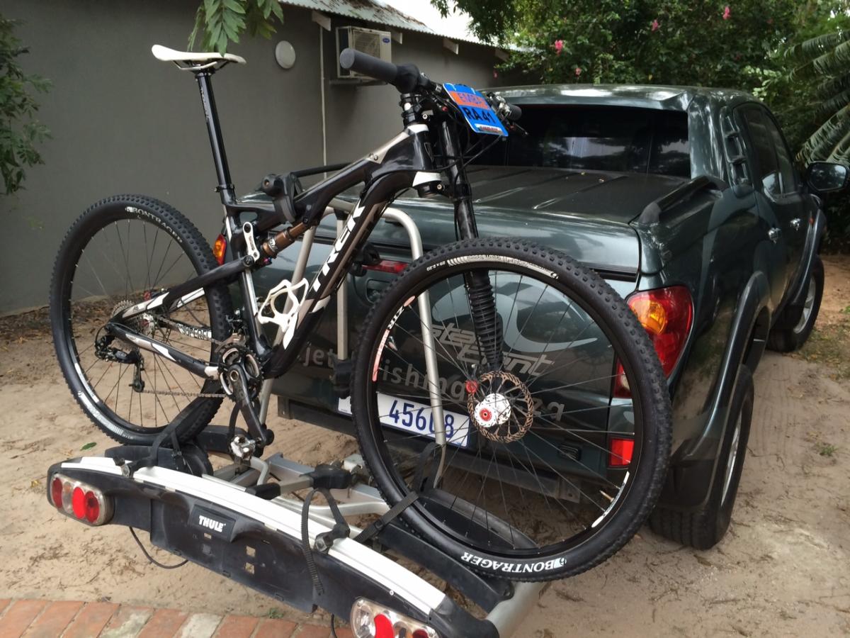

PoiZoNouZ Posted December 9, 2014 Posted December 9, 2014 Saw this while on Holiday in Ballito. I think he fell hard and broke off half his fork...
