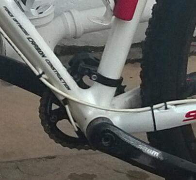

I use an SRAM X7 Rear Deraiileur that does not have a clutch. With a narrow wide chain ring the chain does come off now and then. Installed a cheap chain guide on top of the front chain ring that seems to do the trick.

What "cheap chain guide" are you using and where'd you get it?
Well a full csixx xc is about r1000 or if you have pArts and just want a small alloy part for the set up it's a nice R500 just to blink!
There is money in chain guides.
