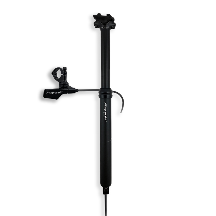

I'd like to know if the new Rapide External dropper is the same as the Lyne External V2...
Trying to compare the service kits online, but it isn't conclusive.

Also looking at a new cheap decent dropper.
Had a Lyne on the previous bike. Was faultless. Preferred it to any other dropper I've used (reverb, KS, spez, giant)
Looking now at trying out the Rapide ones.
R1999 for a 150mm 30.9 post. (versus the R2899 Lyne dropper with the same specs - also no stock atm)
Any known objections?
Else I'll have to let you know how it goes.
