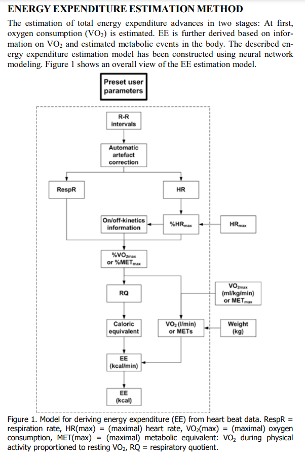

There are other equations too. I should've posted the link to the website..
https://optimistminds.com/how-does-strava-calculate-power/
