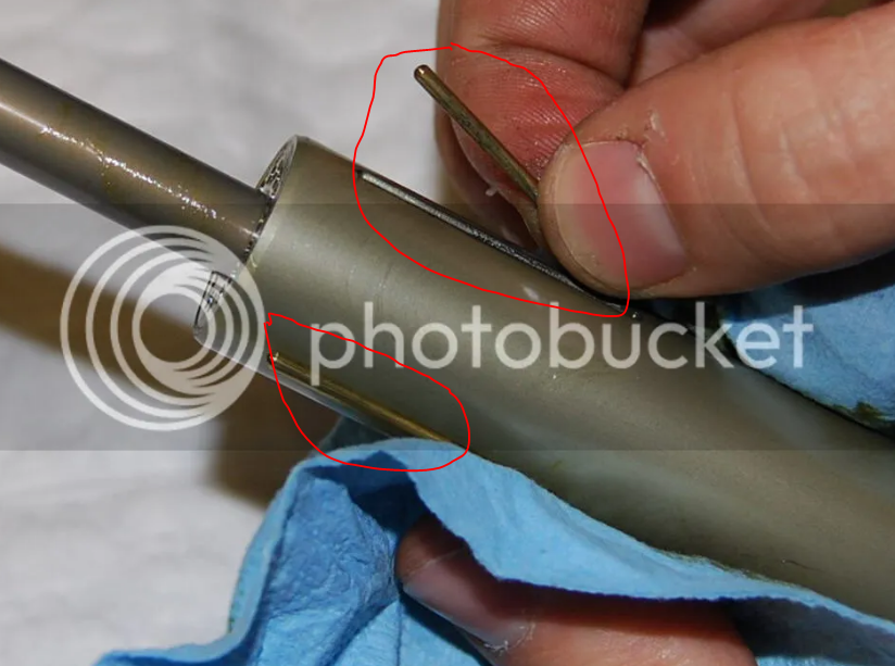

I don't know the Lynne dropper, but on the ks lev the rotational slop is easily serviceable by replacing the 3 brass pins, they consider this a serviceable item and sell the parts online - Takes 30 min to do.

I've done plenty of the KS carts, and the main thing is to make sure there's no air in the oil side of the system. Have a look at the Rockshox Reverb manual for pointers. I've never used an oil bath and I've never had issues with sag.
The other pointer, and this goes for all posts, is never to pull up on the post while it's compressed.

I’ve replaced the contour v2 pins twice. I also replaced the plastic bushes at this time. It was better for a week or two then the slop was normal. Now the post rattles if it’s up and I’m off the seat. Very annoying.
