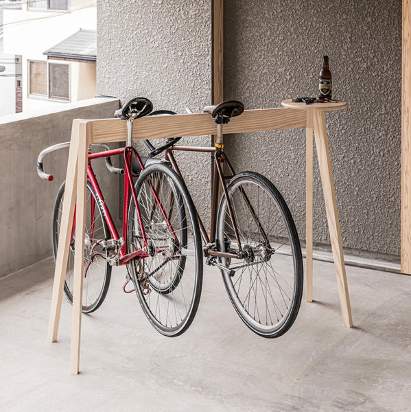

Excuse my ignorance but wouldn't one of these work? They look really simple to make if you want to do it cheaply. I see them outside a few coffee shops but have never used one, so I can't comment on whether they damage saddle rails but nothing some foam can't fix.
Triathlon Stand Legs (Set of 2)
upcycled minimalist bike stand wooden – Storage for Sports

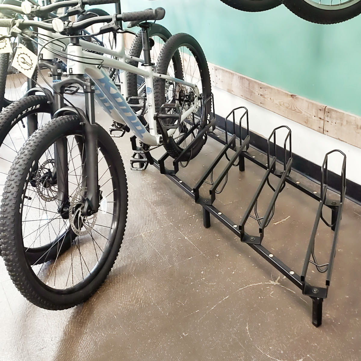

Something like this?
https://trailwolf.co.za/products/steadyrack-mtb-rack?srsltid=AfmBOoo9pBnNKaL794dmFXJvVqALS2JB2UQEgMEy-9rPWZsvL7il6iAr
https://bestbikestorage.co.za/?gad_source=1&gad_campaignid=17806078733&gbraid=0AAAAAowO8bF6Hzwr43SsLg4x7o3LE3K84&gclid=CjwKCAiAoNbIBhB5EiwAZFbYGDhfPnmRUZ9HNd2lad0gQ5hOVq76A9UrErPXTlusYzA8zy5YqCoqDRoCvKQQAvD_BwE
1 hour ago, Old and Slow said:
That's very cool, and could work nicely!

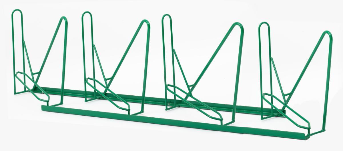

So our problem is we have zero parking bays available, only a few meters of walkway that still needs to be accessible enough for patrons to be able to walk through.
So the stand solution can't extend more than 1m from the wall into the walkway, hence the need for some kind of custom solution.
This is the best example I can find of what I am looking for, although I would need more space between the bikes and a greater angle (bike standing almost parallel with the wall).
So far the most viable option is the one @Danger Dassieshared, but R12k is a bit steep when you buy 6 of them.
