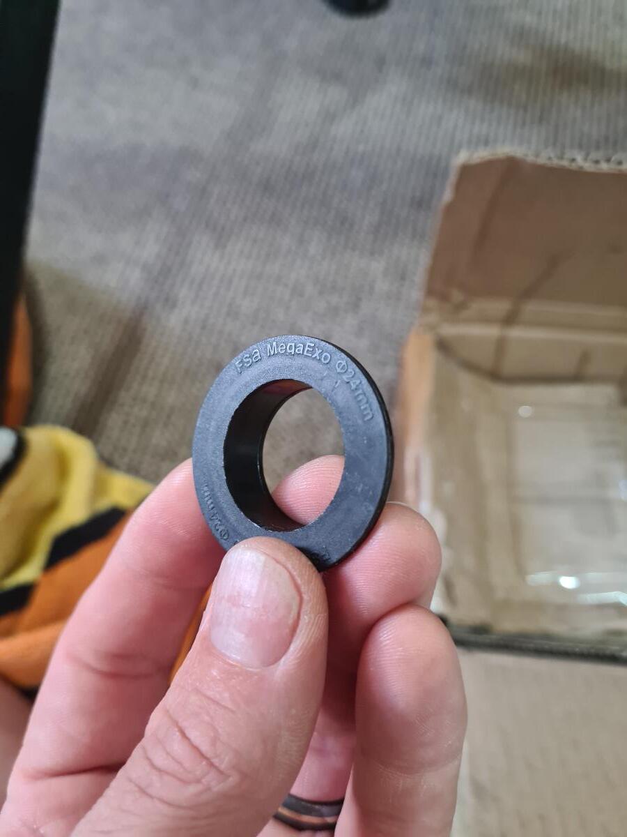

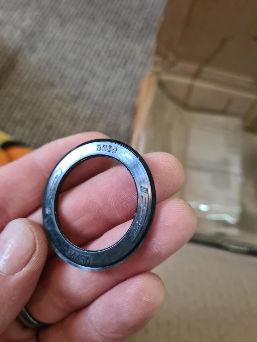

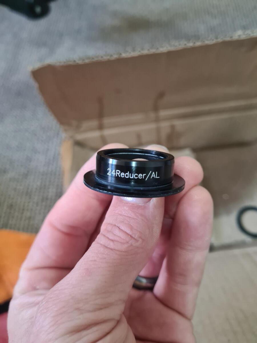

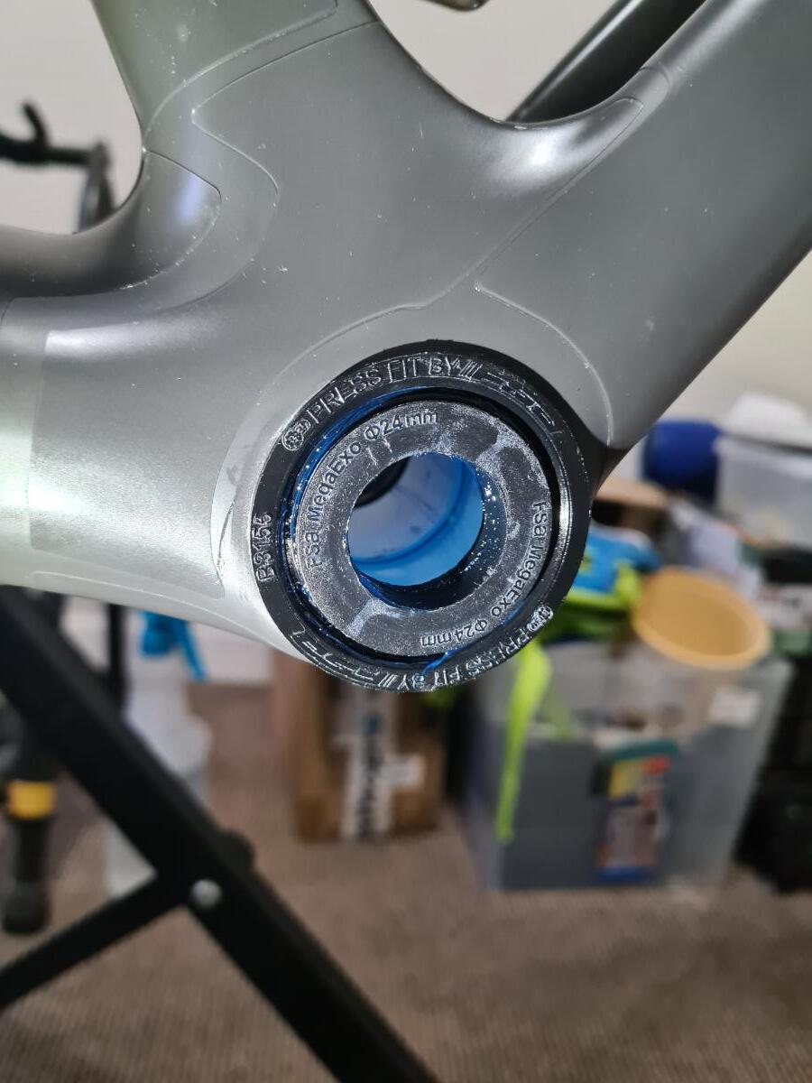

After the rub on gear 4 try backing it off 4x then test then 5x and test shouldn't need to go 6 or 7 as 5 should be center.  Do you have any crank spacer on the drive side throwing chain line out?
20251209_191504.jpg.2745e8a36c4a728e3a329571fc1e7648.jpg20251209_191356.jpg.4460612d093b76d836d88b55b8b434e5.jpg20251209_191513.jpg.d3baafdda037784bbbe338e7c103434b.jpg20251209_193841.jpg.22dce5ea82d2a24b9512a2f464e7bf14.jpg
I have done everything in the video. Thanks for suggesting it. I have tried backing 4x, 5x, 6x, 7x, all with no change.
I attach some photos of the components of the BB and spacers.
