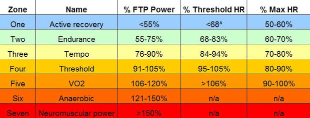

Here we go in picture format  :whistling:
A nice workout to do for FTP is over unders - take for example a 10 minute interval block and break it up so that you do 1min @95% FTP and then 1min @ 105% FTP keep going up and down like that till you done 10 min total, rinse and repeat  :devil:
