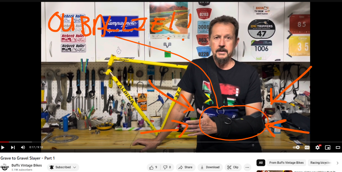

BuffsVintageBikes Posted June 1, 2020 Share I've got some video's on youtube you can take a look at that will assist you. Just search on Buffs Vintage Bikes.Certainly worth restoring and enjoying, most Bianchi's retain their prices well leon_pro, Jakkals., Rowl and 2 others 5 Link to comment Share on other sites More sharing options...

Markellis Posted June 1, 2020 Share I've got some video's on youtube you can take a look at that will assist you. Just search on Buffs Vintage Bikes.Certainly worth restoring and enjoying, most Bianchi's retain their prices well I found your videos last night got them lined up to watch Hairy, leon_pro and BuffsVintageBikes 3 Link to comment Share on other sites More sharing options...
