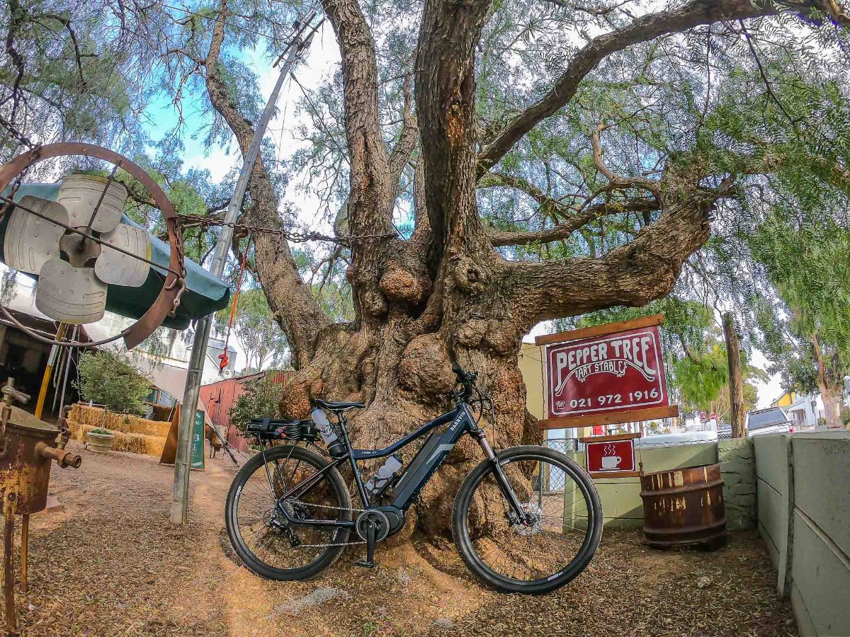

I did the Massive Eastern Cape Passes bikepacking route recently with a mate who did it on an ebike. I have attached his write up as there is some good stuff to be gleaned on bikepacking with an ebike. He does give the details of his ebike, but more importantly it does show that ebikes can work really well for bikeacking/touring.
