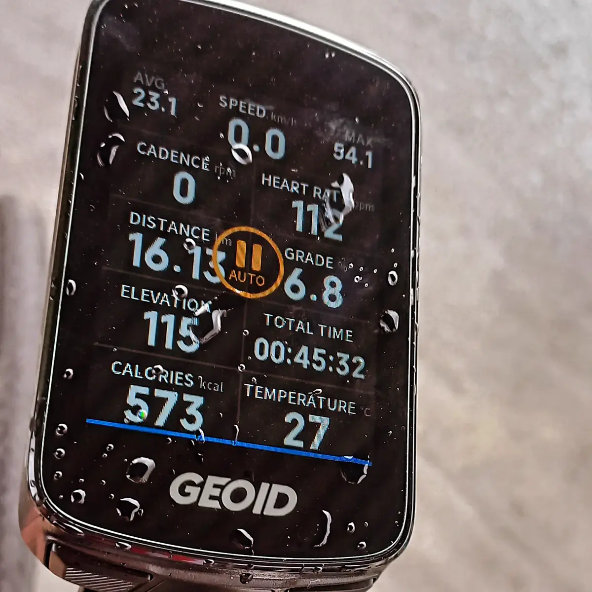

I decided to abended the thing and use my Fenix for the time being, that was 2 years ago. I bought  my self a Geoid 700 Pro the other day for under R2000 and best buy ever!!!
IMG_20260222_191128_290.jpg.c9c17f88e93a
