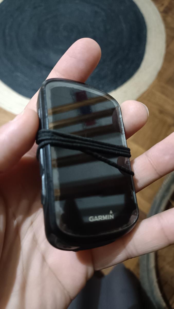

My screen on 530 started unglue'ng itself and coming loose a few rides ago. Wrapped my elastic around it for. Any long term hacks or just old Q bond?
I have stuck a strip of transparent packing tape (wide Sellotape) over the screen to hold the shards together and it seems to work fine, but not sure for how long.
Just some feedback - I am a complete DIY retard, had a similar situation & same temporary solution. Ordered a new screen online months ago but postponed replacing the screen as the tape was still holding and I don't trust my DIY abilities. Then this morning on a training ride I hit a cat-eye and the screen came completely loose and stopped working altogether.
Got home. took out the replacement screen and swapped screens in 2 minutes. Garmin looks as good as new, it was flippen embarrassingly easy - didn't even need to watch the Youtube video.
