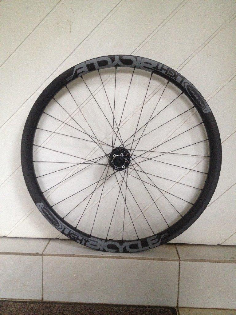

Have a look at Dabomb Advance rims they are 30mm internal and weight 495grams per rim. They even have eyelets on them,speak to ED here on the forum.
Thanks TJ
Those DaBomb's look like... well... da bomb! Good price too.
I have a set of these in black and white,been on my bike for 2 weeks now but sadly have not had time to test them but this weekend it's happening will report back.PS. They make your tires look like a tractor tire.
