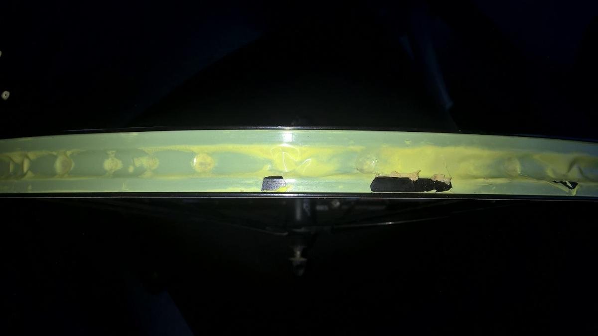

Urgent help needed - strange problem - UPDATE

I am hoping the tyre rather than the rim, will have to make a plan to get another tyre and test.

If there is a lot of congealed sealant around the valve seat on the inside of the rim, perhaps that might be the problem - must be one of the weakest point in a tubeless rim

Thanks for all the input guys. Going to try one of the guys at works Maxxis Ikon tomorrow to rule out the tyre.
Will keep everyone updated.
Will be dissapointed if it turns out to be the Racing Ralph tyre, its only 2 years old with about 6 000 kms on it. :)
