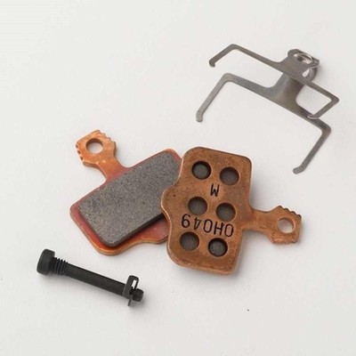

I know... it sucks. Just to put the pads back in!!! half an hour to get it right. I replaced my Shimano Deore pads on my other bike in 1 minute.
Say what !!! Explain what takes you that long to do.
It takes me less than 5 min both sides, adjusted/centered and running smoothly.

It was very difficult to seat them. You push the pads in and the clip on the other side pops out so you have to keep it in place firmly with one hand while you try to make the pads click onto it while keeping them aligned with the spring thingy with the other hand. Shimano ones you just slide them in an slide the lock pin easily.

Juicy 3. I must say that the front caliper was easier than the rear. I guess depends on frame/fork types. The thing is that the pads need to be placed from below the caliper and that makes it more difficult. In contrast, Shimano Deore's are just slid from the top of the caliper which makes it easier IMHO.
