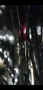

Difficult to take a photo as it's on the hub now. I've just left it and put the wheel back on the bike,new chain and and chain and to my surprise, no skipping gears,not adjustment needed and all seems to spin perfectly.

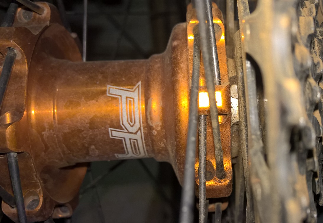

Alan I know what you are refering to , i can't wangle my phone between the spokes to get a pic of the piece of freehub that you can see but ti got a pretty good pic of the "gap" and it's dead normal
You can always see that bit of the gold freehub on hopes ( my pro4 and pro2evo both have this "gap")
I doubt you have anything to worry about , just make sure the cassette is around 35nM or in other words **** TIGHT

That's exactly what I'm talking about. It just doesn't sit flush and move all the way down on the hub to where it should stop. Ypur seems to stop wjere it should but my cassette doesn go all the way on the hub to where it should stop.
I've tightened it as tight as I can and that's where it sits.
All gears working perfect and all seems aligned nicely.
Will try take a pic a little later

That is normal for an XD cassette.
Make sure the cassette only has a slight wobble when you spin the cranks backward. If its pronounced you may have cross threaded the cassette . Only ever seen this once
